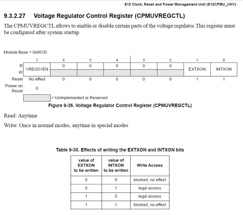

When I checked for datasheet I found this register.
and updated code as below.
GoToSleep();
SCI0ACR1_RXEDGIE = 0;
LP0CR_LPWUE = 0;
CPMUVREGCTL_INTXON = 0;
CPMUVREGCTL_EXTXON = 0;
I observed the problem still exists.
How to overcome this problem.

The VDDX cannot be disabled – the CPU is powered from it.
The CPMUVREGCTL allows configuring VDDX only in one of two configurations (select internal or external VDDX regulator). See table 9-30.
Additionally, this register may be written just once in normal mode (until next reset).
Both internal and external regulators are enabled by default after reset. Since the target voltage for the external regulator is slightly higher, the current will flow through external PNP when the external PNP transistor is assembled. So, this VDDX settings in CPMUVREGCTL is useful rather only for tuning applications during power dissipation tests (the external PNP transistor allows offload heat generated by VDDX regulator).
In fact, both internal and external regulators are disabled in MCU stop mode. The VDDX voltage in stop mode is driven by Reduced Performance Mode (RPM) regulator with the limited current capability and slightly lower accuracy. On another side, this regulator is resistant to the short circuit.

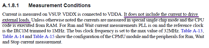

danielmartynek
Hello [email protected],
The current consumption specified in the RM is taken at certain conditions which does not include the current to drive external loads (A.1.8.1.S12ZVL rev.2.48).
When SW9 is switched, the current sourced from VDDX is 5V / 5,32k = 0,94mA
