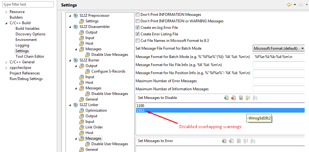

Since such type of placement is still manual, the linker parameters must be configured for avoiding possible overlapping.
Be aware! The default CW project has disabled memory overlapping warnings.
So, we must exclude target memory area from linker using. For example, in the *.prm file:
