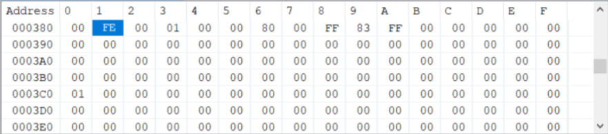

I use S12ZVML31 mcu. I've problem. FSEC register is not correctly loaded from configuration field after reset in my application.
I use this code:
volatile const unsigned char flash_array[] @0xFFFE00 = {0xAA,0xAA,0xAA,0xAA,0xAA,0xAA,0xAA,0xAA,0xFF,0xFF,0xFF,0xFF,0xFF,0xFF,0xFF,0xBD};
The following code is added in prm file
ENTRIES /* keep the following unreferenced variables */
/* OSEK: always allocate the vector table and all dependent objects */
//_vectab OsBuildNumber _OsOrtiStackStart _OsOrtiStart
flash_array;_vectab
END
but immediately after reset FSEC is still 0xFE.
I need secure my device but device is still unsecured.

Hi LiZhanWu,
I just see a small syntax issue in the ENTRIES block in prm linker file.
There shouldn't be any delimiter between object names, only space characters.
This may be a potential source of the described issue.
According to "c:\Freescale\CW MCU v11.1\MCU\Help\PDF\MCU_Build_Tools_Utilities.pdf" , chapter 28.1.6 ENTRIES: List of Objects to Link with Application
Syntax(Freescale):
ENTRIES objName {objName} END
So, in your case, there should be only:
flash_array _vectab
END
I hope it helps you.
