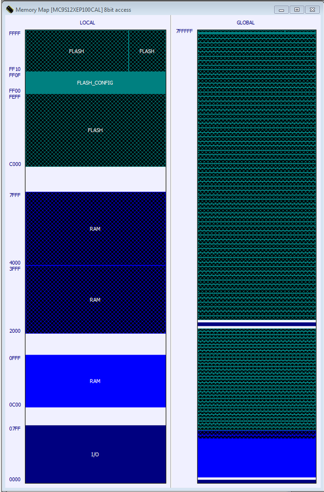

We are planning to use S12X boot-loader for our project.
We are referring user guide https://www.nxp.com/docs/en/application-note/AN4258.pdf and supporting SW package with application note
We have used interrupts in our code and generated code using Processor Expert.
In section number 6 in AN4258.pdf, it mentions that
"If interrupts are used:
4. Trim the segment ROM_4000 from the original size 0x4000–0x7FFF to 0x4000–0x7F0F. The area 0x7F10–0x7FFF
will be used for the relocated interrupt vector table."
We have change the memory architecture as per our requirements, summery of project.prm file as below

We want to understand:
1. As per our memory configuration ROM_4000 section in absent but address range is present, what changes should we do for the boot-loader implementation.
2. What all additional things we need to do apart from mentioned in AN4258 if we want to implement boot-loader on application with processor expert
1,330 Views
lama
The only things necessary to be changed are described in the chapter “6 how to write a user application”. The interrupt table can be placed anywhere in local memory, for example somewhere between 0xC000~0xEFDF. For example just on the beginning 0xC000. Then, of course, at the application start the IVBR must be changed to point to a newly placed vector table.
