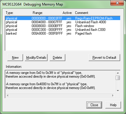

About missing 9kB of flash)
You deleted 0x0C00-0x2FFF (9 KiB) from memory map.
I agree with you that Table 5-8. Global Address Ranges in RM is confusing. However there is one detail which you miss. Table 5-8. describes Global address map.
Range 0x0C00-0x2FFF in local memory map is equal to 0x0C8C00-0x0CAFFF (local memory map-paged) and this equal to 0x30C00’G-0x32FFF’G(global memory map).
Linker understood addresses in local memory map, for global addresses you should add “ ’G ”.
Page 0x0C you can define as:
PAGE_0C       = READ_ONLY   0x0C8000 TO 0x0C8BFF;
ROM_0C00      = READ_ONLY     0x0C00 TO 0x2FFF; /*equal to 0x0C8C00-0x0CAFFF*/
PAGE_0C_B000  = READ_ONLY 0x0CB000 TO 0x0CBFFF;
Or you can omit non-banked mirror and just use banked form:
PAGE_0C       = READ_ONLY   0x0C8000 TO 0x0CBFFF;
Access to non banked flash is faster, therefore default CW project use ROM_0C00 sector.

puppetmaster
Thank you for all these answers.. I try to give a proper response on each of them.
Actually I deleted this sections since I didn't get it to run with my constants. It's exactly the same behavior as if I would put them into the paged area
I've attached three screenshots to clarify what I mean
I even tried to use
0x30CC'G TO 0x32FFF'G
as you suggested, but the elf loader does not understand it; though the linker does.
So next to the screenshot here is what the map-file says (don't be confused with the section, didn't change the name, just the destination address)
OS_APPL_CONST_UNSPECIFIED        640     R      0xC00      0xE7F   ROM_4000_MODULE_CONF
OS_APPL_CONST_8                    4     R      0xE80      0xE83   ROM_4000_MODULE_CONF
As you can see the addresses are correct, but the contents are 'empty' for the 0xC00 to 0x2FFF range
It looks exactly the same (except the address) in comparison to the 0x4000 address range.
OS_APPL_CONST_UNSPECIFIED        640     R     0x4000     0x427F   ROM_4000_MODULE_CONF
OS_APPL_CONST_8                    4     R     0x4280     0x4283   ROM_4000_MODULE_CONF
"Access to non banked flash is faster, therefore default CW project use ROM_0C00 sector."
My Codewarrior 5.9 does 0xC000 as default , ignoring 0x0C00  and outcommented 0x4000.
I gladly would like to use this 9 KiB section since I assume to never blow that boundary which makes it way easier for my bootloader (I partly erase flash, thus the 512Byte alignment) and having every constant in one place is the best after all...

RadekS
0x30CC'G TO 0x32FFF'G is wrong range. 0x30CC'G is address from RAM.
Valid range is for example 0x30000'G TO 0x33FFF'G.
However S12G hasn’t GPAGE therefore range in global addresses has not sense.
Equivalent range in logical addresses is 0x0C8000 TO 0x0CBFFF.
I tested project in CodeWarrior and you are right. There is some issue with flash data in range 0x0C00 to 0x2FFF. CodeWarrior is not able program it. For example in case of S12G128 it works correctly (range 0x1400 to 0x1FFF).
I will contact CW experts with this issue.
As workaround I would like to recommend define page 0C as paged flash:
If you write constant at address 0x0C8C00, you will see the same constant also at address 0x0C00.
I also discover that Debugging Memory Map in default project doesn’t contain banked flash range.
For debugging is necessary change memory map in menu->HC12MultilinkCyclonepro (or another BDM interface)-> Debugging Memory Map…
For example:
16,947 Views

The debugging memory map issue occurred to me as well... Thanks for the suggested fix, it works splendid :smileyhappy:
