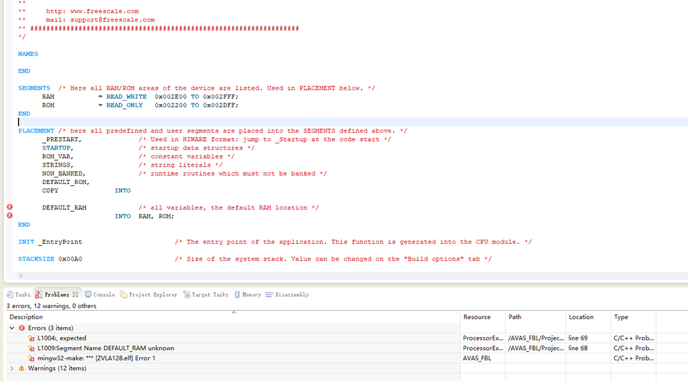

Our customer has a request on our bootloader, that is, the flash diver must not stored into the flash, it should download from CAN cummunication and then excute it to do flash download operation,when reset ,the data have no. I had noted that our community have some question about how to excute a function on ram, but they were all store into the flash, and when needed or program start, copy to ram, they are still store in flash.  what I need is when: excute compile, I can get a section of target file in ram. not place in flash.  and i have tried to do this, so I modified the prm file: use the ram as read-only type and place function in ram ,but the IDE prompt error

You didn't complete ...,COPY INTO destination, that's the source of your error. You shouldn't touch PLACEMENT section at all, only change SEGMENTS section to make ROM pointing to addresses in RAM, trim RAM segment to make room for ROM. Yes, it could be as you do
   RAM = READ_WRITE 0x002E00 TO 0x003FFF;
   ROM = READ_ONLY  0x002200 TO 0x002FFF;
please restore PLACEMENT section.

PLACEMENT
    _PRESTART,
   STARTUP,
   ROM_VAR,
   STRINGS,
   NON_BANKED,
   DEFAULT_ROM,
   COPY                                INTO
   DEFAULT_RAM
                                     INTO RAM;RM;
   END
a,b,c INTO x;
d,e,f INTO y;
x and y are entries form SEGMENTS..END. You have only RAM and ROM segments, so INTO can be only into RAM or into ROM, but you made INTO pointing to DEFAULT_RAM, which is incorrect and this is why Codewarrior complained.

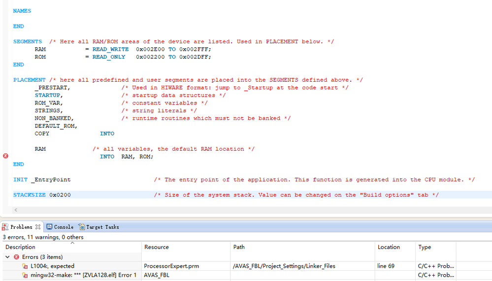

Arghh. You broke PLACEMENT section of your PRM, I explained why it is broken. You need to restore it, just that.
4,819 Views
oceansea
hi,
i do change follow your idea , it show :
i  replace DEFAULT_RAM to RAM ,but it still  show some wrong
4,819 Views
kef2
Senior Contributor V
again, I suggested you to restore PLACEMENT block to it virgin state. You broke it again. RAM can't be at the same time SEGMENT and PLACEMENT. a,b,c INTO RAM INTO RAM, ROM; . If you don't know how to restore PLACEMENT block, create new project and copy PLACEMENT from there.
