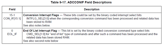

Dear Team,
I am using S12ZVML128 MCU.
I want to know that, If ADC sampling/conversion of signal is in progress and during this time if we read the result list of that signal then we will get the garbage value or the old value of that signal?
Request you to please inform me the answer as early as possible.
Thanks in advance.
1,246 Views
danielmartynek
Hello Pratibha,
The RAM result list holds the previously written results until the flags are set again.
