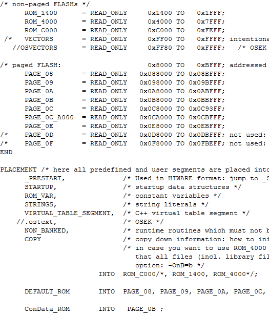

Based on S12G128,
Firstly, placed some const at PAGE_0B,

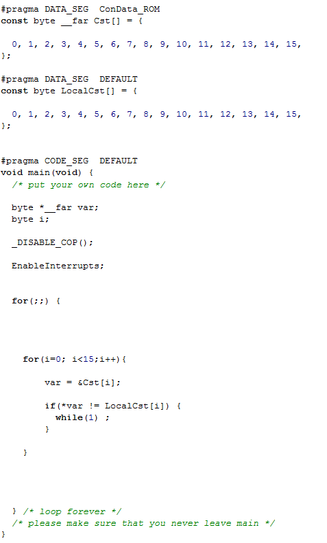

Secondly, place the same data at NON_BANKED
Finally, you can check whether reading result of paged const is right.
Of course, they are the same.
