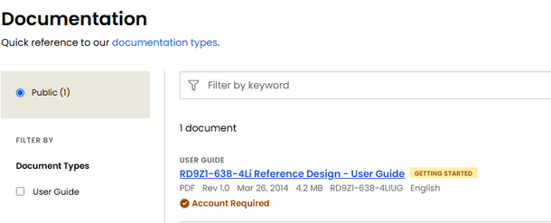

您好,恩智浦合作伙伴。我购买了 RD9Z1 - 638 - 4Li 开发板和 BDM 编程器。您能告诉我应该从官网下载什么软件来设置编程和烧录环境吗?谢谢
Hello, NXP partner. I purchased the RD9Z1-638-4Li development board and BDM programmer. Can you tell me what software I should download from the official website to set up the programming and burning environment? Thank you

Have you downloaded and read the user guide?
You can find it here
https://www.nxp.com/design/design-center/development-boards-and-designs/mm9z1-638-4-cell-lithium-bat...
I suggest to visit www.pemcro.com for the last USB BDM multilink interface compatible with Windows11 and S12Z family.
Then you will need to download CodeWarrior® for MCUs (Eclipse IDE) - ColdFire®, 56800/E DSC, Qorivva® 56xx, RS08/S08, S12Z - 11.1
https://www.nxp.com/design/design-center/software/development-software/codewarrior-development-tools...
Here you can see differences between versions
