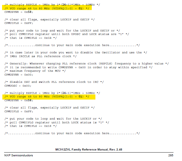

In page. 235, chapter '9.3.2.4 S12CPMU_UHV Synthesizer Register (CPMUSYNR)', I found the following information:
However, in page. 285, for the ‘9.7.3 Application Information for PLL and Oscillator Startup’, it says that range is between 48MHz to 80MHz for VCOFRQ[1:0] = 01:

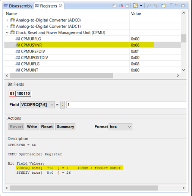

I have also seen the same information in my register window when I was debugging:
Could anyone confirm which is the correct range for the setting?
Thank you,
Junxi

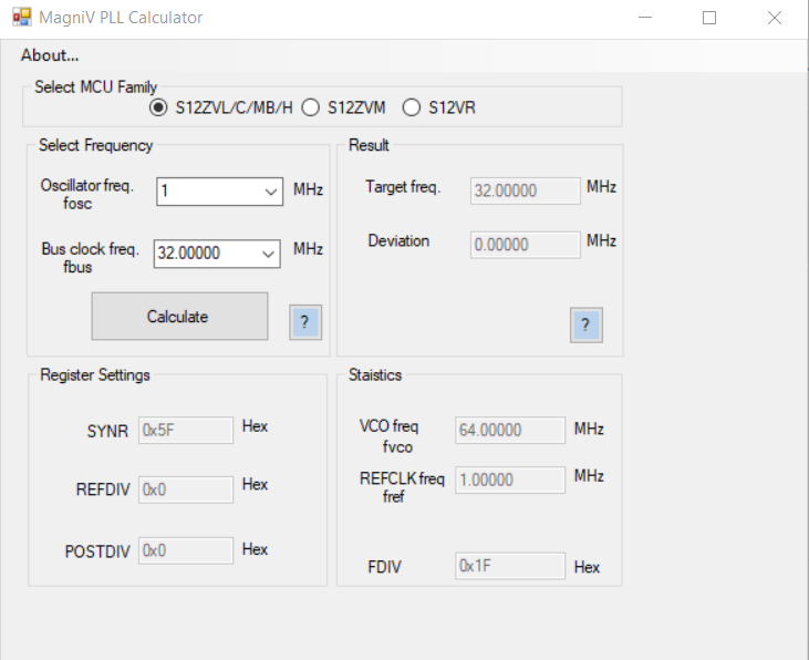

in order to be sure you can also use: https://community.nxp.com/docs/DOC-341785

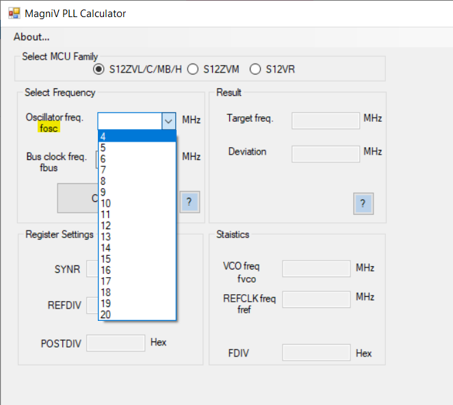

Hello Lama,
Thank you for sharing the tools. I got one question here for setting it up.
For the Oscillator freq, I am using the internal clock fIRC1M which is 1MHz (OSCE=0), I find I cannot find the correct value here to run the calculation.

lama
So write 1 to the cell.

Hello Lama,
Thank you for the suggestion, I tried it works. I think the maximum I could go is 64MHz for fvco with SYNR 0x5F.
However, what I have seen in my setting is SYNR 0x66, which makes the fvco 78MHz.
If I am using this setting for the fvco, is that means the actual fvco is still 64MHz instead of 78MHz? Or something else?

80Mhz mentioned in 9.7.3 Application Information for PLL and Oscillator Startup looks to be a copy/paste typo from a datasheet with the same peripheral but higher frequency possibilities.
You wrote you have CPMUSYNR = 0x66. It is not correct value. The data sheet says to use max fvco=64MHz. If the setup is made by any tool then it must be a bug if it uses fvco= 78MHz for this type of MCU. However, it is possible that this setup will provide you "correct" busclk (I mean the MCU will work) but you will use the MCU out of operating specifications (>32 MHz). I suggest you to change it to defined range.
Your original values:
fref = 1
fvco= 2 * fref * (syndiv+1)   ; 0x66=0B01100110 => SYNDIV=0B100110=38
fvco= 78MHz => out of el. specification range
Busclk = fpll/2 = (fvco / (POSTDIV +1)) / 2 = 39MHz  => out of el. specification range
Required values for fbus=32MHz:
SYNR = 0x5F
REFDIV =0
POSTDIV=0
Ladislav
