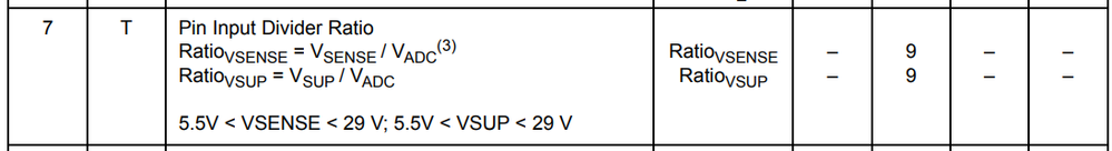

I am using 'MC9S12ZVHY' series MagniV Microcontroller. Need to monitor the Analog voltage range from 0 to 5 V.
I am using the VSUP pin for this purpose which can be routed to internal ADC through an Internal Voltage Divider.
The VSUP pin has following characteristics :
i Am confused with the above mentioned Condition " 5.5V < VSUP < 29 V" .
My Question is:
Can i use the VSUP pin as internal ADC to Measure analog voltage from 0 to 5V Range?
Please help me on this issue.
Kunmit

Hello Kunmit,
The VSUP voltage is divided by 9 (+- 5% max error) and this is what the ADC can measure.
However, it can’t measure in the whole range of VSUP (Table I-1, #1, S12ZVHY RM), It is limited to 5.5V < VSUP < 29V.
Meaning that if, for example, VSUP = 4V, the ADC result would be higher as if VSUP was 5.5V.
