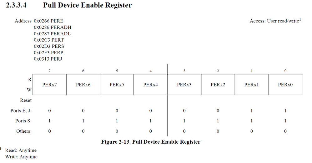

I checked datasheet of S12ZVC for pull enable register setting.
I have a question.

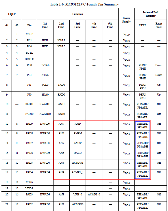

I think AD0~AD7 are PERADL, AD8 ~ are PERADH.
if yes, datasheet has an error.
if not, why AD6 and AD7 are PERADH?
How can I set pull-enable to AD8 or higher?
Thanks.

You are right this is a typo.
Thank you for your report, it will be forwarded to an application engineer.
