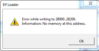

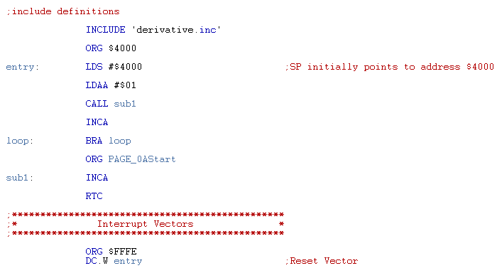

I have been using CodeWarrior IDE v5.9.0 build 5294 (Development Studio for S12(X) v5.2 build 151201) on a Windows7 machine for about a year to upload assembly code to the DEVKIT S12G128 board without any problems. Last week I started using paged memory as my project has exceeded 64K. I now receive an error message when trying to upload code to the DEVKIT S12G128.
I can't even upload the following simple program:

Pressing "Make" assembles this program without a problem, and I can view the main.asm.o.lst file but when I connect the DEVKIT S12G128 and press "Debug" I receive the following error messages:

I tried opening a new project and also tried uploading from another computer with the same version of CodeWarrior, but the same error messages appear.
As mentioned above, programs that do not have paged memory upload without any problems.
Please help!

Your error will happen, when you use PAGE_0AStart:       equ   $00028000 -> this address is global and you are accessing out of memory.
When you want to access on the PAGE 0xA, you need to use alternative addressing for PPAGE.
So, address will be  $0A8000
This should work:
             ORG    $4000
entry:    LDS      #$4000
             LDAA    #$01
             CALL    sub1
             INCA
loop:     BRA      loop
             ORG    $0A8000
sub1:    INCA
             RTC

danielmilutinov
Hi Diana, thanks for your reply. Can you please tell me what changes I need to make to the code? Do you mean I should change it to:
What about ORG $FFFE? Are you saying that all addresses must be changed to global when using paged memory? Can someone please show me what changes need to be made to the code to get it to work?

danielmilutinov
Hi Diana,
You are a champion, that works perfectly!
Thank you very much for all of your help!
