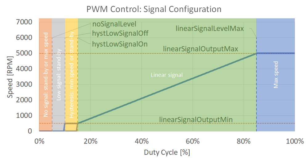

PWM Signal Specification
Since there is no public standard specification on PWM signal, let's target a general case with adjustable parameters. Since the PWM control signal is being replaced by LIN communication, the specification may be based on 5.5V to 18V voltage range with nominal 12V level. PWM frequency varies from 10 Hz to 1 kHz (or more), but it really depends on the requirements of the application, compatibility, etc. Duty-cycle range of the PWM signal might be from 15% to 90% from stand-by to full speed. Hysteresis at low duty-cycle range (between 10 and 15%) prevents the system from periodic on/off switching at the lowest duty-cycle. Duty-cycles outside of this range may be identified as not valid and appropriate action may be taken (e.g. full speed command to an engine cooling fan).
The signal definition should consider some specific values to help with the signal reading. Following values are defined:
Label
Description
noSignalLevelNo signal detected below this duty cycle
noSignalOutputOutput on "no signal" detected
lowSignalOutputOutput on "low signal" detected
hystLowSignalOffLow level of the hysteresis. Smaller duty-cycle means "low signal" state, higher duty-cycle enters the hysteresis range (min speed or stand-by)
hystLowSignalOnHigh level of the hysteresis. Smaller duty-cycle means "hysteresis area: min speed or stand-by", higher duty-cycle means "run"  in the linear signal range, with the speed given by the duty-cycle.
linearSignalOutputMinLow level of the linear mode
linearSignalLevelMaxHigh level of the linear mode
Considering normal operation in stand-by mode, the duty-cycle is between noSignalLevel and hystLowSignalOff. In order to add some distortion-proof feature, the duty-cycle can go up to the hystLowSignalOn and the stand-by mode would be still detected. In order to engage the "run" state, the duty-cycle has to exceed the hystLowSignalOn value and the linear area is reached. Corresponding output is calculated to meet the linearSignalOutputMin at the hystLowSignalOn value and linearSignalOutputMax at the linearSignalLevelMax. System keeps the output at linearSignalOutputMax for duty-cycles higher than linearSignalLevelMax. When slowing down, reaching the hystLowSignalOn sets the output to linearSignalOutputMin and keeps this output until the hystLowSignalOff is reached. This way, the hysteresis feature is provided in order to prevent motors from randomly switch on and off in case the PWM signal is noisy. Lowering the duty-cycle below the hystLowSignalOff, zero output is set, which represents the stand- by mode. Duty-cycles below the noSignalLevel are treated as not valid and noSignalOutput is engaged (which can be set to zero or to max, according to the application requirements).

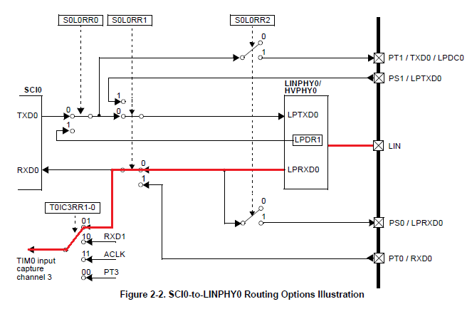

Requirements on Timer
In order to correctly detect PWM signal frequency and duty-cycle, hardware timer with input capture feature and rising/falling edges detection shall be used. Timing and chaining of multiple timer channels may be needed to increase the frequency range or duty-cycle resolution. Following example will be simplified to use just one 16-bit timer channel (timer module TIM16B4CV3 used in S12ZVML128). The input of the timer shall be routed to an input pin, on which the PWM signal will be sensed. Integrated LIN physical layer module of S12ZVML128 device can be used for signal conditioning since the signal voltage range is up to 18V. In the example, LINPhy module has to be enabled and the LPRXD0 signal is routed to the timer T0 input capture channel 3 by setting "T0IC3RR1-0" of the MODRR2 register to 0b01. Input capture and timer overflow interrupts are used to detect correct or faulty signal.

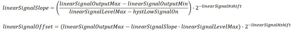

Linear Output Calculation
Linear output calculation is an easy way of interpolating two endpoints by a linear equation. In order to calculate the coefficients (slope and offset) and to improve the fixed point range, shifting is implemented as well.

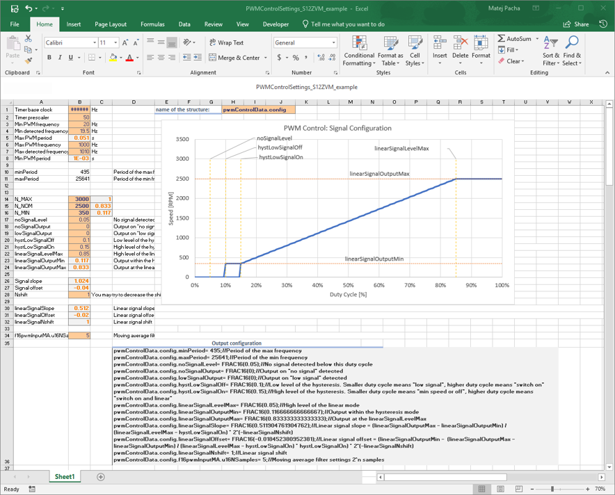

The configuration can be generated using an Excel sheet in the attachment. Content of the cell "D34" can be copied-pasted in the code. Name of the structure can be changed in "H1" cell. Orange-colored cells are customizable, while grey-colored cells use formulas to calculate output.

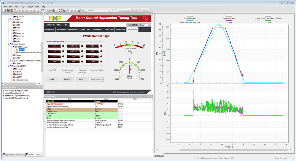

Finally, within the application task, the PWM control data can be accessed and used in the application. For example, based on the ControlInputClass, the input signal processing may be enabled or disabled and the output value can be used as the required speed value of an engine cooling fan.
[Application Task]
 // PWM Control
 // If no signal is detected, enable manual switch (using FreeMASTER)
 if(pwmControlData.ControlInputClass == PWM_NoSignalDetect)
 if(pwmControlEnabled == true)
 cntrState.usrControl.switchAppOnOff = 0;
 pwmControlEnabled = false;
 else
 pwmControlEnabled = true;
 // If PWM input control enabled, update the demanded speed
 if(pwmControlEnabled)
 //If the linear or high signal is detected, switch the app on
 if(pwmControlData.ControlInputClass >= PWM_LinearCtrlDetect)
 cntrState.usrControl.switchAppOnOff = 1;
 //Store the demanded speed
 drvFOC.pospeControl.wRotElReq = pwmControlData.outputValue;
 //else switch off the app...
 else
 //...and if a fault is indicated, clear the fault
 if(cntrState.state == fault)
 cntrState.usrControl.switchFaultClear = true;

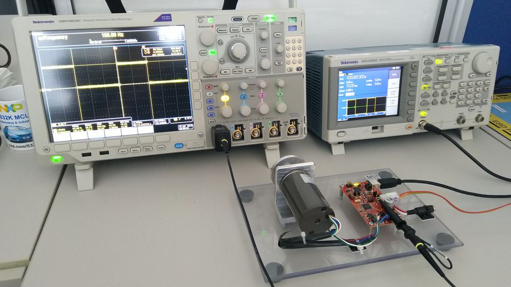

Example code
Example code is provided for S12ZVML-MINIKIT. The code is a modified devkit SW, which is available here (and related AN5327 here). The FreeMASTER project file is included with added PWM Control subblock. If there is no PWM signal detected, the application can be controlled via FreeMASTER on/off button. If the PWM signal is detected (even with a duty-cycle below the minimal value), the application listens and reacts as defined by the signal definition.
