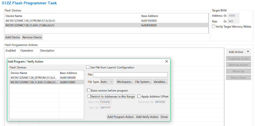

Hello S12Z team,
I am trying to flash and this message comes up..
"Can't program 8 bytes to address 0xff0128 because this range isn't included in the selected modules! "

What I am doing wrong? What I have to change that this doesn't shows up.

I only want to program Flash.
I just created a new project in codewarrior and used Flash file to target and there I used my own ".S2" file.

So you use the S12Z Flash Programmer Task and select Flash device, right?

The two addresses are not EEPROM but flash.
What do you want to program? EEPROM or Flash?
How did you configured the Flash Programmer?
