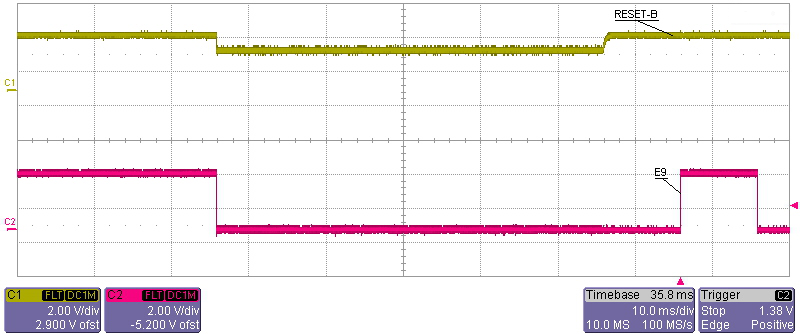

I'm using the Mc9s12d64 on a selfdesigned board. My Problem is, that i can't communicatewith the chip.
The NoICE-DEbugger reports the error:
"BDM validation failed: MODE=0xFF BDMSTAT: =xFF
This may indicate incorrect MOD setting (MODA and MODB must be grounded), that the pod cannot reset the target, or an incorrect bus speed setting"
I testet the Mod's anb both A and B are grounded.
When i start the communication the Reset-line goes low for 19,5ms then back to 5V, same with the BKGD-line! THe bus speed is set correct (16MHZ crystal => 8MHz Busspeedhttp://dict.leo.org/ende?lp=ende&p=DOKJAA&search=crystal&trestr=0x801). What can be the issue fpr this problem. The crystal also works fine (tested with oscillioscpoe). Can the microcontroller be broken? That would be the first time, this happened....
Please, please help me, because i have no more ideas where i can look for solutions.

Above i attached an image of the reset and bkgd line signals. So the reset controller is okay i think...
I think the probem is that the chip dors not answer via the bkgd-line and i absolutely do not have a clue why :-(

kef
Specialist I
Looks like there's connection between BKGD and /RESET.
Is crystal oscilating? Try powering board up with BKGD tied low. Is ECLK pin oscilating? What frequency?
Make sure you didn't connect 2.5V power pins to 5V supply. Some pins are powered with about 2.5V from internal voltage regulator. Only bypass capacitors should be connected to these pins.

thommes
This is my scheme. Hopefully this is enough for understanding.
And sorry i did not read carefully. I measured 16MHz at XTAL and EXTAL. On Pin ECLK i measure 5V but without any Frequency.
Normaly the Board should come up in Normal Mode and when the ComPod12 is connected the special single chip mode should be used.
It seems that i can't reach the "Special mode" and therefore i cannot communicate with the Target?

Ok, I'm back with new testings made and new informations.
1) I connected BKGD to GND and messured ECLK. I saw just 5V and i thought a frequency should me measured or am i wrong? So what does this mean?
2) I Monitored Vddr, Vddx and Vdda -> all stay at 5V while reset and after.
3) THe MCU decsription is: MC9S12D64 - MPVE -0M89C - QQNW1018
4)I attached a file where you can see Reset and BKGD line when i start the NoIce-communication (or try to communicate...)
The green channel is Reset.
The yellow channel is BKGD.
I made the same with the CardS12 module from Elektronikladen and had a look on the communictaion.
There is more communication, which seems to be like the 4 spikes i see in the attached file, is like a "hello MCU are you there?" But there is no answer from the MCU so the "handshake" fails. Right?
