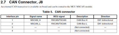

Dear Team,
Is inbuild CAN transceiver added with  MTRCKTSPNZVM128 deployment kit.?
1,215 Views
StanoA
Hello Pratayay,
yes, the external IC is implemented on board connected to connector J8:
Stano.
