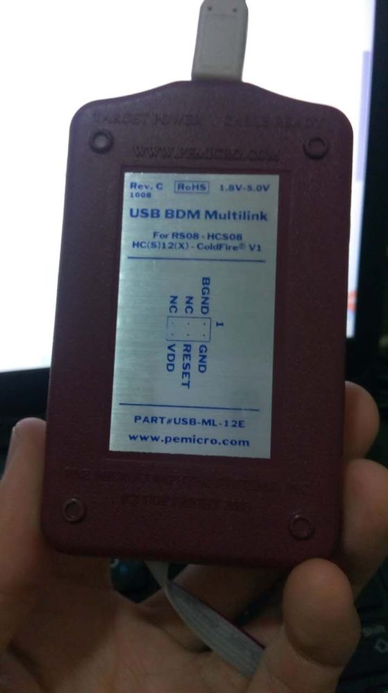

Hello all:
1 . when I using CW10.6  and P&E to program the MM91j638,it come out the following warning:
fl::target -lc "LC for Simple Flash"
fl::target -b 0x1000 0x2000
fl::target -v off -l off
cmdwin::fl::device -d "MM9Z1J638_FLASH" -o "128Kx32x1" -a 0xfe0000 0xffffff
cmdwin::fl::image -f "E:\\HG_WORK\\HG_BMS_Project\\Code\\TestProj\\PE_test_J638\\FLASH\\PE_test_J638.elf" -t "Auto Detect" -re on -r 0xfe0000 0xffffff -oe off
cmdwin::fl::erase image
Beginning Operation ...
Auto-detection is successful.
  File is of type Elf Format.
Performing target initialization ...
Device MM9Z1J638_FLASH is protected
Erasing .........
Error:  Erase Command Failed.  Operation timeout.
An invalid preference was passed to the GDI protocol plugin(HC/RS/S12Z GDI Protocol Adapter)
Error: Erase Command Failed.Operation timeout.
2.Does the P&E tool can support this MM9ZJ638 chip?
Expect your help ,thanks in advance.

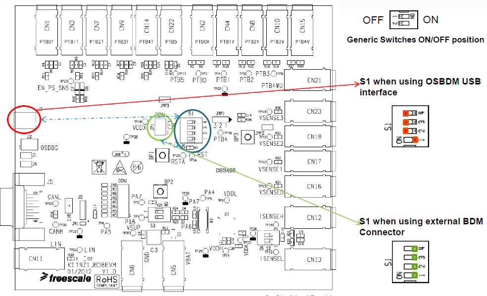

Hi Tang,
I use our KIT9Z1J368EVM board and PEmicro USB BDM Multilink without any problem.
Please let me know whether you use KIT9Z1J368EVM evaluation board or your own board.
If you use KIT9Z1J368EVM evaluation board, please check S1 switch positions. It should be connected according to this picture:
If you use your own board, please check whether you disconnected the connection between RESET and RESET_A signals. The analog die contains a watchdog, however, this watchdog isn’t triggered during programming MCU and automatically try to reset the MCU.
At KIT9Z1J368EVM board, this connection is driven by S1 position 1 switch.
I hope it helps you.
