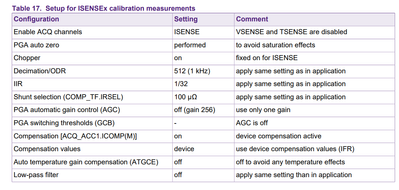

diazmarin09
Hello cui1,
Could you please confirm that VSENSE and TSENSE are disabled? Is the chopper enabled?

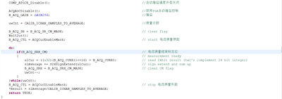

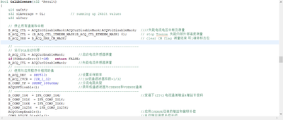

cui1
Hello David,
The above program follows the NXP software template, non-calibration module, normal reading current can reach 700A, calibration module program, reading current can only reach the maximum 50A
Cui1
3,148 Views
cui1
Hello David,
As shown above, the voltage and temperature are disabled and the current is activated. I think it has something to do with gain, please refer to it.
