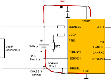

Question 1 : When collecting HV current with MM9Z1_638, does the GND of the module need to be connected with ISENSEL?

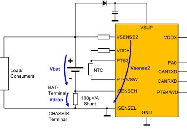

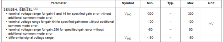

The MM9Z1_638 is measuring the ISENSE using GND referenced Inputs. The table below (from the datasheet) indicates the limitations / requirements for proper operation:
VINC    is the voltage from ISENSEH to Gnd and from ISENSEL to Gnd
VIND       is the differential voltage between ISENSEH and ISENSEL
Typically the IC/module GND point should be on the Shunt resistor either the "ISENSEH-side" or "ISENSEL-side".
ISENSEL side referenced to GNDISENSEH side referenced to GND
Current measurement (ISENSE)I load + I supI load
Voltage measurement (e.g. VSENSE2)V bat + V dropV bat
