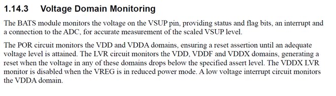

When the MCU suddenly loses power,what is the eeprom normal working voltage in MC9S12ZVL?

Hi @jingfang,
The NVM domain is VDDF which is monitored by the LVR circuit.
The NVM is operational down to LVR.
BR, Daniel
