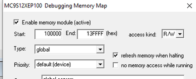

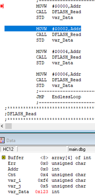

MC9S12XEP100. Code Warrior 5.9.0, single chip, absolute assembler.
I have a program, similar to the one I wrote using the MC9S12C64, but larger and more complex. I couldn't figure out the flash burner process for that one until I posted the question and Ladislav was able to explain it to me with his C64-FLASH-ASM test program. Using that I was able to get my program to work just fine.
Now I am having the same issue using the MC9S12XEP100 processor. I was hoping there would be enough similarities in the process that I could adapt what I learned, but I'm having some difficulties. Is there a test program similar to the C64-FLASH-ASM, but specific to the MC9S12XEP100 in single chip, absolute assembler that I could study and see if I could get that to work?
I'm attaching a basic test code that I am using to troubleshoot.
Robert

I am not sure what are you looking at so more detailed comments. Moreover, I suppose the DFLASH is in erased status before it is written.
Moreover, the question is how the RAM content is refreshed in your memory window. You should also check the setup lime it is done for DFLASH.
The address 0x2100 is selected by compiler so the array is placed:
Buffer[0] is at address 0x2100,0x2101    of a  local address space
Buffer[1] is at address 0x2102,0x2103
Buffer[2] is at address 0x2104,0x2105
Buffer[3] is at address 0x2106,0x2106

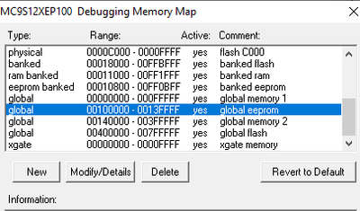

Finally, it is good to understand local and global address space. The RAM 0x2100 is in local address space 0x2100 and in the global address space 0x0F_E100. Si memory map in attachment.
... and be careful when you show address space ... extension 'G  or 'L. For example 0FE100'G and 2100'L represents the same address from different views.
lama_0-1745926193582.png  .... does no exist
lama_1-1745926193582.png .... the variable "buffer" in a local address space
lama_2-1745926193583.png ... the variable "buffer" in a global address space
better comments of the original asm code..

Hi Ladislav,
Thanks so much for your detailed response. There are still a few minor errors in your comments, but no matter, I'm quite sure I know what you are doing and they really helped.
Your screen shots of the memory window were a big revelation to me. I didn't know about the l, g and r suffix. That explains a lot.
The spread sheet that compares the equivalent addresses also really helped in my education. I now feel I have a good understanding of what you have done and a better understanding of what the debugger can do.
As a result of my new found knowledge I am realizing that I should be using EEPROM emulation. I have some questions about that in a separate thread.

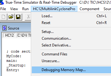

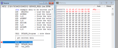

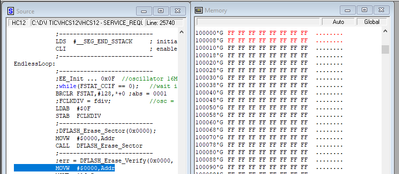

4,934 Views
lama
  • Do not step memory functions if the part of memory is displayed in the memory window of the debugger.
  • Set refresh memory when halting
  • First loop
  • Second loop … after erase sector
  • Second loop after writing data
  • Second loop reading the data
    lama_6-1744187836726.png lama_7-1744187836730.png lama_8-1744187836733.png lama_9-1744187836736.png
  • Moreover, it is always suitable to disable possible interrupts to do not change registers.
Create critical section which is not interrupted using CLI, SEI.

I have the memory set to refresh on halt, but no matter what I do, the memory never changes. I've tried setting breakpoints where I see you have highlighted, but nothing. I tired running the program and halting it at random points. No change. What am I doing wrong?

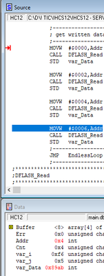

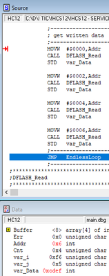

I've spent a lot of time stepping through this code and recording all the variable and register states on each step. I think I have a pretty good understanding of what is happening here, but one thing in particular still has me puzzled.
In this section of code:
LDX #Buffer ; Load the base address of the array into X register
LDD #$0123 ; Load the value 0123 into A register
STD 0,X ; Store the value at the 0th position of the array
X is loaded with $2100, the address of "Buffer" in RAM
D is loaded with decimal 0123
Decimal 0123 is copied into the first two bytes of the "Buffer" array at address $2100 in RAM.

I when I single step through the program I expected to see the RAM addresses from $2100 to $2110 update with the appropriate steps. I'm not seeing this.
I also expected to see the D-Flash addresses from $10000 to $100010 update as I step through, but I'm not seeing that either.
Also, if I run the program and halt it, the memory locations are not updated.
Are there some settings in the de-bugger that I don't have set right?

After stepping through the program again several times I noticed some other peculiar things.
After running the FLASH_ERASE_VERIFY subroutine the returned "err" was $01. Which was expected. However, after any FLASH_PROGRAM subroutine "returned "err" was $40.
The FLASH_READ  subroutine seems to work but it doesn't return the var_Data values I expected.
It returns $FA, $CF first. $4 second. $BB $B6 third.  $46 $46 forth. The values at address $100000 are $FA, $CF, $00,$04,$BB, $B6, $46, $46. These are not the values that should have been burned to this address if I am understanding the program correctly.
The values at address $2100 are $CA,$FE,$CA,$FE,$CA,$FE,$CA,$FE and they don't change.
Something seems odd here.
Robert
