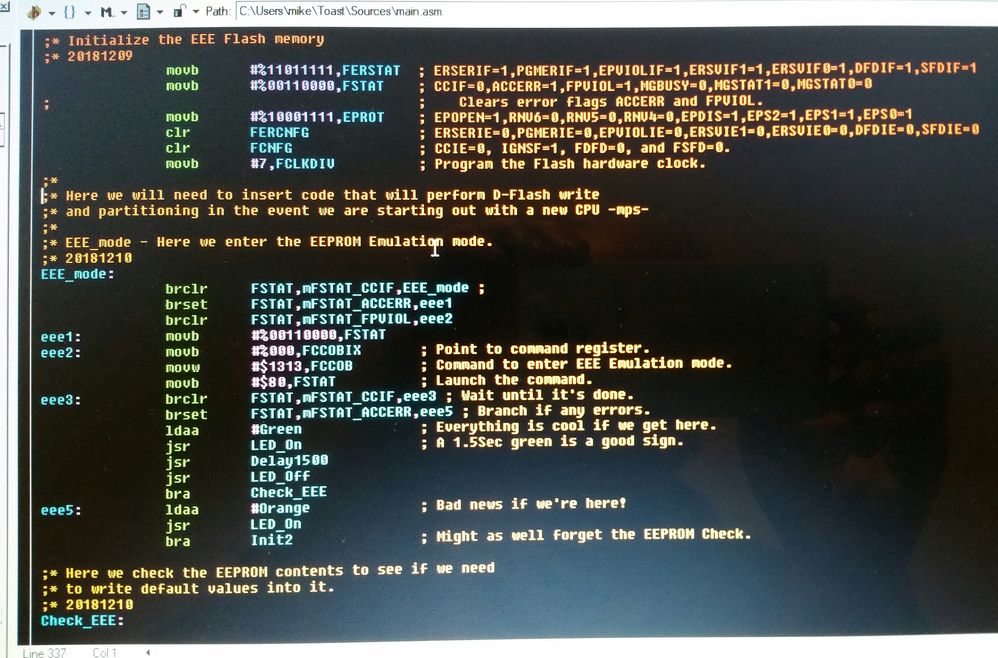

  1. There is very little mention in the documentation of what the Tag RAM is used for on the S12X series microcontrollers.  I am ready to use the EEE on the S12XEG128 and successfully enabled the EEPROM emulation command.  In the datasheet "Chapter 24 128 KByte Flash Module (S12XFTM128K2V1)" there is a paragraph that says: "Upon clearing CCIF to launch the Enable EEPROM Emulation command, the CCIF flag will set after Memory Controller enables EEE operations using the contents of the EEE tag RAM and tag counter."  My question is: What do I need to do with the tag RAM?  What data do I put in there if any?  Anyone that can help I'll be so thankful!

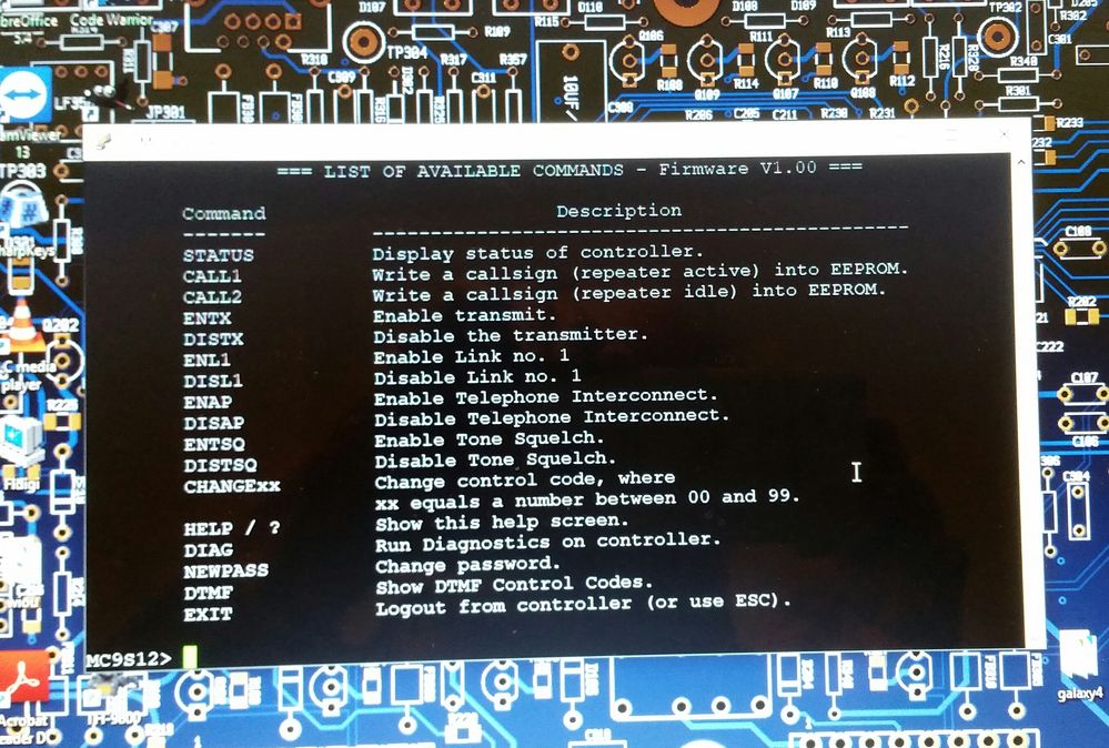

I think I've answered my own question.  I have finally figured out how to use the EEE emulated flash and I am stoked!  I'm having too much fun writing assembly on this awesome part (MC9S12XEG128).  I guess I don't need to really be concerned about the tag ram.  Writing to the emulated RAM automatically writes to the Flash memory now that I have everything written properly.  The secret to the success of writing on this part is to read, read, and read the datasheets!  I have included three photos of my project and I hope I can help someone else if they are having problems using the EEE using assembly coding.  I also have both SCI ports working.  One driving a vacuum florescent display and the other one connected to my laptop (dumb terminal).  Hope you enjoy my photos.  Thanks again NXP for supporting this excellent microcontroller.  It will live a nice long life as an Amateur Radio (HAM) repeater system controller.
