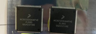

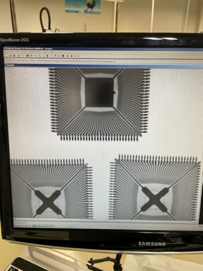

we have received MC9S12D64MPVE with different nomenclature (MPVE on same line and MPVE on different line). The die structure of IC is little different. Is it acceptable as per NXP documentation?
1,004 Views
lama
I have got info that it is OK.
However, more important is whether you bought the device from an official distributor. If not, then we do not guarantee quality.
