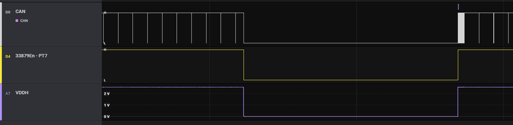

vardhan
I am working with CAN transmission on MM9Z1_638 with demo board RD9Z1_638_4Li Rev 1.2, We establish CAN communication between MM9Z1_638 and MICROCHIP CAN analyzer with demo code (RD9Z1_638_12VLA_CAN_demo). My aim is to work low power modes with CAN protocol, in this process i am setting MSCAN is in Sleep Mode and MCU in stop mode and according to the datasheet to wake the MCU from stop mode using PTB4 ( For Wake-up  i am setting of the NWUE bit in the GPIO_IN4 register and with the Wake-up Enable Bit (WUPTB4) and the port configuration bit (PTWU) set) But i am unable wake the MCU.
Please help me to sort of this problem and I am attaching my code here

I just tried it with the RD9Z1_638-4Li board and its works Sleep (=STOP) and Wakeup.
Trace Sleep -> WakeupTrace Sleep -> Wakeup
You can see the Goto To Sleep -> PTA7 = low and VDDH = 0V and wakeup via CAN PTA7 = high and VHHD = 2.5V.
