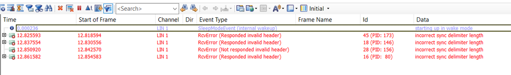

I developed a software using Lin stack as the master role to send 2 lin messages to control 2 slaves to light the led respectively.
If I only connected  any one of the  slave to LIN bus together with Master, it works well.
If I added another slave to LIN bus to work together with their, the connection will be failed. At that time,  "RcvError(responses invalid header)" will be reported in Event Type column and "Incorrect sync delimiter length" will be reported in Data column when I using CANalyzer to check the trace window.
Did any person have ever has this kind of issue? was it related to the LIN stack configuration or had some other reason?

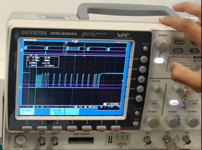

It is recommmanded to use 2 or more bits in sync break delimiter area. But in my project, the default value in lin stack is 1 bit.
And if the Master and slave were supplied with normal voltage 12v or lower voltage, the issue is there. If I raise the voltage to 13.5v or more, this issue disappeared. then I checked the waveform using oscilloscope, the waveform was not so good as is shown below.
It was effected by the capacitance value beside the LIN transciver of Lin slave. I changed the capacitance value from 1nf to 220pf, then it works in 12v condition.

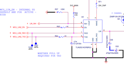

HanamantKaluti
Hello Team,
We are facing the same issue for the S32K314 board, we tried with increase in the voltage but it didn't work.
I will share the picture of of the signal and the schematic diagram below,
Please let us know how we can solve this error...
Signal:
Schematic:
