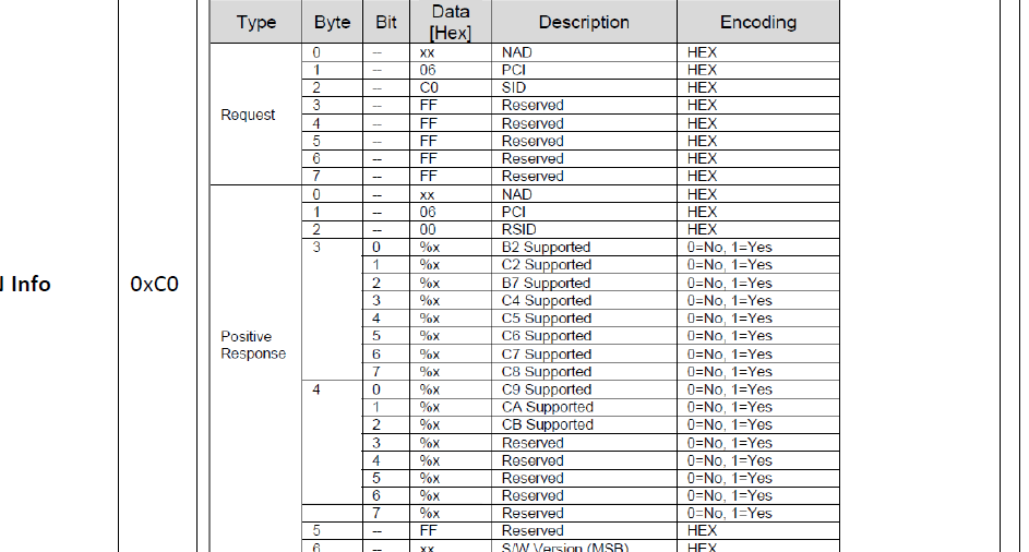

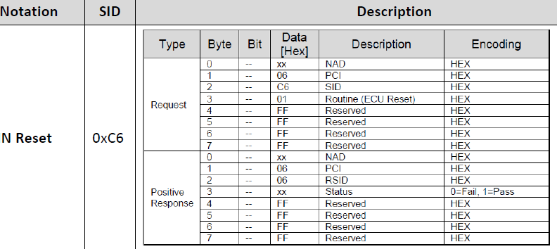

1.now i have to use some additional  feature in our diagnostic class 2  as required by customer as listed below .
reset , information , hw vesion sw version etc  i have to the use SID c6,c8 in our slave but i don't know how to do ,please suggest .
for example for reset .and information of ecu are listed below

RadekS
Hi deepak,
In this case, you want to use support_sid feature in diagnostic class 3. This feature was not supported in FSL_LIN_STACK v4.5.4. It is supported since version 4.5.6
Unfortunately version 4.5.6 was not published yet on our web pages (we working on that). Please download and use attached version 4.5.6.
In Version 4.5.6, for these requests, users should use Diagnostic Class 3 (since 0xC0, 0xC6 are user defined SID which are not supported in Diagnostic Class 2 according LIN Specification).
1)            IN NPF files:
Add support_sid for SID 0xC0 and 0xC6 using Eclipse GUI for example: user = 0xC0; user01 = 0xC6
2)            Then generate lin_cfg files. You can see that 2 flags are generated for SID user and user01. { DIAGSRV_USER_ORDER; DIAGSRV_USER01_ORDER }
3)            In Master’s application: Users can send request data similarly in the case of sending Read Data by Identifier or Assign Frame ID Range
4)            In Slave’s application: Users can detect whether slave has received Master request with SID user and user01: Do similar as in the case of processing Read Data by Identifier
  if(diag_get_flag( DIAGSRV_USER_ORDER)
  l_u16 req_len = 0;
  l_u8 req_data[10];
diag_clear_flag(DIAGSRV_USER_ORDER);
  /* Process data */
ld_receive_message(&req_len, req_data);
  req_data[0] += 0x40; // RSID = SID + 0x40
/* Put your code to perform necessary action here */
/* Send response */
  ld_send_message(10, req_data);
I hope it helps you.
