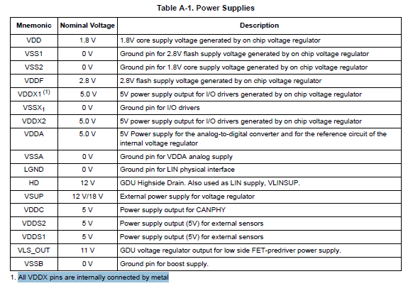

Is VDDX1 and VDDX2 of S12ZVML connected internally?
946 Views
danielmartynek
Hello nobuyuki_mihara@nexty-ele.com,
Yes, as you can see in the S12ZVM RM rev.2.13
