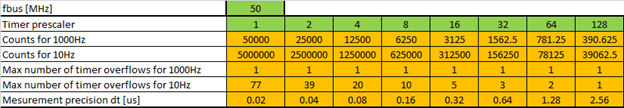

1)
  1. a) The first idea of measuring both pulse parts was described previously.
  2. b) Probably I can add that the type of edge can be also investigated by interrupt flag, without enabling interrupt, at two independent pins connected also to input signal.
  3. c) The issue you have is to make a compromise for maximum precision of the 1000Hz frequency and amount of overflows for 10Hz frequency from timer prescaler point of view.
  4. d) You should perform your own analysis a decide for timer setup as presented in the example, file main.c:

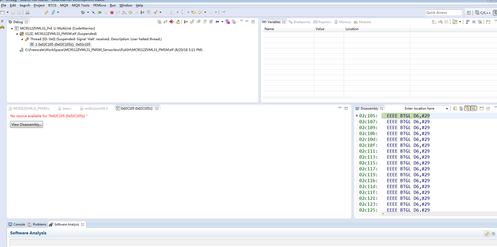

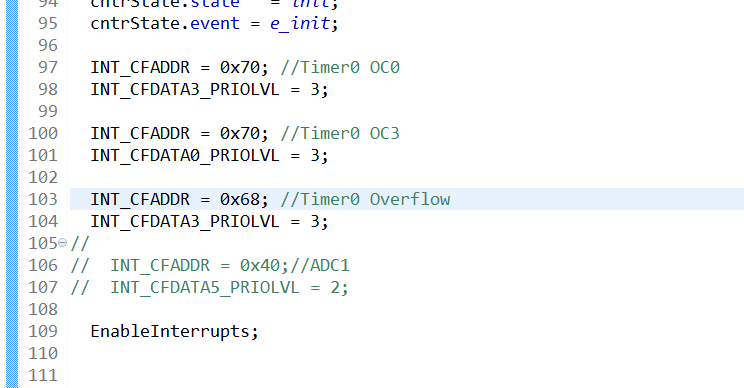

I have a idea for this problem. I use the interrupt of Timer0 IOC0 and IOC3. IOC3 is for input capture and IOC0 for output compare. The timer base frequency is 200K. If I add the compare value at IOC0 interrupt , then I can generate a 10us interrupt. I will deal with the output compare using the period interrupt(10us)  for 10hz~1000Hz. The problem is when I set the different priority it will meet some problem. If I set the same priority it works well. You can see the problem below:
  I want to set the priority of IOC0 is higher than IOC3, what can I do?

   It does't work. Because the max frequency of Timer1 is 50M, the overflow time is 65535/50M = 1.31ms .It's too long for checking  square wave with 1K Hz frequency.
   any other ideas?
