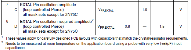

Before you use PLL be sure the oscillator is working correctly.
1. Use normal passive crystal. (oscillator) Active, are not supported by S12G device.
2. To check correct behavior, use PBE mode and you should measure frequency of BUSCLK=OSCCLK/2 at ECLK pin. Of course you have to set ECLKCTL_NECLK=0. This says you, without measurement, whether your oscillator works.
The data sheet states:
C: Those parameters are achieved by the design characterization by measuring a statistically relevant sample size across process variations.
D: Those parameters are derived mainly from simulations
The PLL setup for different modes: https://community.nxp.com/docs/DOC-93792
