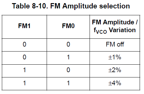

S12ZVM Reference Manual says "FM1 and FM0 enable frequency modulation on the VCOCLK. This
is to reduce noise emission". How to understand that ?
In my understand, for example, PLL output ( VCOCLK ) set as 10MHz and FM set as '01', actual VCOCLK  is 10±0.1%. Is that correct? How about FM off?

   How do VCOCLK change if FM is enabled? In some rules, such as  sine wave, or random.
    Best Regards.

The frequency is in the triangle waveform.
I would like to at the note that if you don’t have a problem with EMC emission, rather don't use frequency modulation.

      Actually, I have problems with EMC now. I saw below note in the manual. Does it mean that if I enable PM as '11', 4% variation, then bus clock must set to less than 46 MHz, considering that S12ZVM maximum bus clock is 50 MHz?   If  exceed the maximum clock, what will happen?

The bus clock frequency range of S12ZVM is 1MHz - 50 MHz. This range should not be exceeded.
For example, if you are using 46 MHz bus clock freq. and +-4% FM you should consider that the bus clock frequency will be 44.16 MHz - 47.84 MHz. So, in this case, we are in the specified range.
If the maximum frequency of the bus clock is exceeded we cannot guarantee the correct behavior of the device.

The frequency modulation PLL function will reduce the noise amplitude because it spreads this over a greater frequency range. If FM function is enabled it must be taken that maximum bus frequency is not exceeded.
- If frequency modulation is off (by default) IPLL block, try hold VCOCLK on one stable frequency.
- Additional frequency modulation of VCOCLK spreads frequency spectrum around VCOCLK.
So, if modulation is set as ’01’ the VCOCLK variation will be within +/- 1 %.
