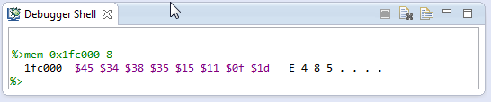

Even the datasheet does not present the device ID it can be read at address 0x1FC000. The device ID is size of 8 bytes from 1F_C000 to 1F_C007. The meaning of the field is confidential information. Of course, other "reserved" fields on higher addresses can also be read but their meaning is also confidential.
The ID is not presented in the documentation because it has reason for company only. However, some users require unique identification of the device. It is possible to use this number.
In order to read the ID, it is enough to create simple project in the CodeWarrior and connect to the device without programming it and run “mem” command in the debug shell window. If you do not want to remember address ranges, then it is better to prepare command file and execute it.
Of course, we can also simply use memory window.

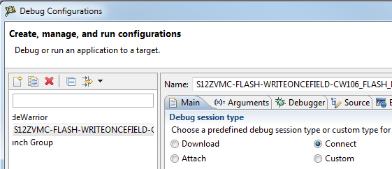

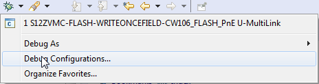

The project which also presents reading and writing program once field is not relevant but should be created for the device we want to play with. It is not required to be code (simple code, enough to use what is generated by wizard) loaded into the MCU’s memory. However, necessary is the debugger is connected to a memory. Because of this it is enough to set:
…. And press debug
In the debug enable “Debugger Shell”:

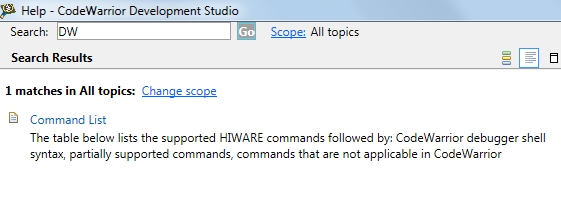

Now the question, where to find commands to be able to prepare such a command files, can be asked.
1) The first information source is the CodeWarrior help. For example, search for keyword DW and it could find a command list.
2) Tcl Reference Manual
3) http://www.tcl.tk/
