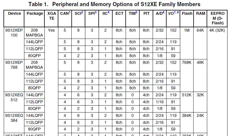

I am using MC9s12XEQ384 in 112 pin package.
I can send data on SCI0, SCI4 and SCI5.  But SCI7 looks like it is not initialised.
This is what my initialisation looks like :

The TDRE bit in SCI7SR1 is never set.
Which to points to initialisation.
What am I missing?

I think I have found it.
My processor does not have SCI 6 and 7

StanoA
Yes, you are right.
As you can see in Table D-2 of Ref Manual: https://www.nxp.com/docs/en/data-sheet/MC9S12XEP100RMV1.pdf
And pinout explanation:
  • Versions with 6 SCI modules will have SCI0, SCI1, SCI2, SCI3, SCI4 and SCI5.
So you can use only 6 SCI modules.
