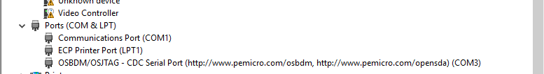

lukmankurniawan
Hi Lama,
Thank you for your reply. Btw, on your device manager showing that you have comport1. But why on my PC only showing OSBDM/OSJTAG without any comport? any driver you install?
Lukman
3,001 Views
lama
I suppose you are connected to the Devkit by USB cable. In this case CodeWarrior IDE uses OSBDM. The OSBDM is included insiede CW IDE as a default communication protocol for debugging so you should use this one. There is commnication device place onto the board which communicates via the same cable as an UART and BDM.
Why Have I COM1? Because my laptop is docked and the dock contains true RS232 connector so if any devkit or developmnet vboard containd RS232 transceiver and connector I am able to communicate also in this way. However, this board does not contain RS232 transceiver so you have to use described way of connection. I have not installed any driver on laptop. i have only selected COM3 in the hyperterminal.
BTW, hyperterminal .. I have only copied exe version and dll file from older PC. You can use another type of similar software. Docklight,......
Once more, no additional installation. Only select COM port assigned to your OSBDM also to your communication SW. Do not forget to set correct bitrate.
Ladislav
