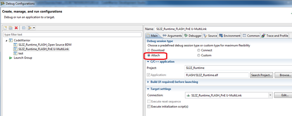

Hi Aaron,
If you want to avoid flash programming in case the device is not secured I'd recommend you to rather to attach to a running device instead of Download:
If the device is secured you will see invalid content like this:
If it's unsecured you should see a valid memory dump.
Hope it  helps.

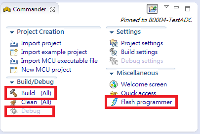

Dear Ladislav,
I am a new NXP user. I only know how to Build, Debug & Flash in Commander.
So, I want to learn how to secure and unsecured.  Your reply very detail. Thank you very much. Now, I understand how to do that.

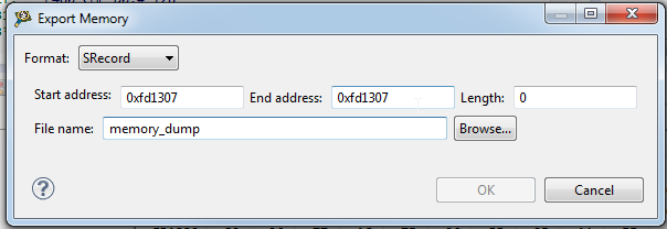

I have another question. How to read unsecured MCU (Ex. S12ZVCA) and save it to PC?
Aaron
3,236 Views
lama

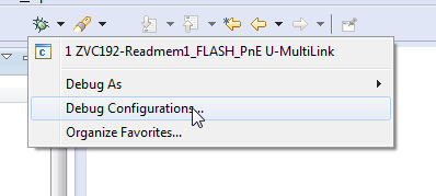

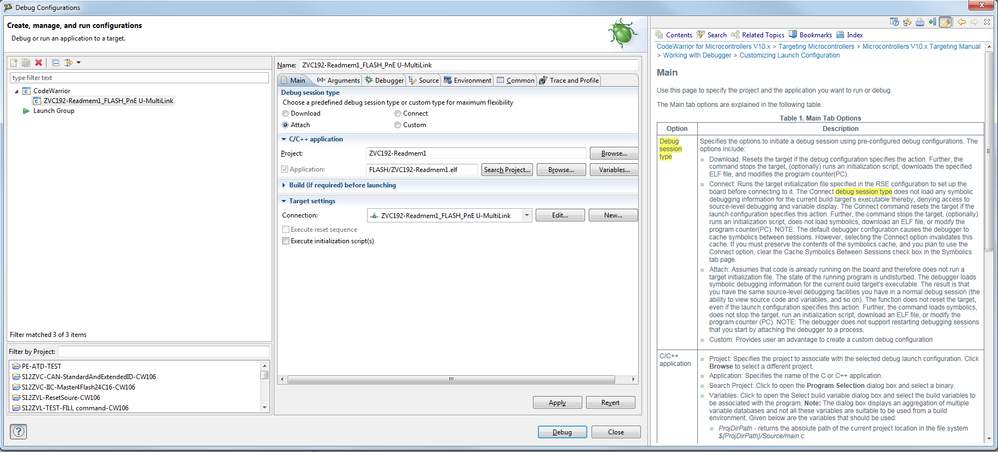

Let's assume there is running code in the MCU.
The easiest way is to create a new bareboard project
and do not change anything but:
1) Open a debug configuration
2) Select attach
3) You can look into a memory window and press export
4) Select entire memory and the name of the file
Thats all.....
best regards,
Ladislav
