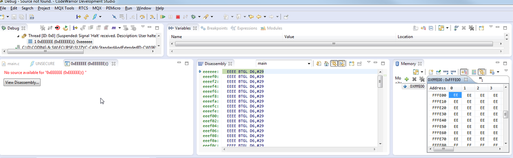

Q1. How to differentiate the MCU is secure or not? Have the simple way to do?
Q2. Is it secure or not when i flash MCU done?

Hi Aaron,
If you want to avoid flash programming in case the device is not secured I'd recommend you to rather to attach to a running device instead of Download:
If the device is secured you will see invalid content like this:
If it's unsecured you should see a valid memory dump.
Hope it  helps.

I hope I understand you well.
When the device is secured then you are not able to neither load the code into it
nor connect to it and the CW reports it before download.
When the mcu is secured then you can see after download:
The only BDM command which is accessible is mass errase which is able to clear entire memory and set the security bits to the unsecure status. Unsecuring can be performed by CW or external program.
So easily, if you are able to connect to it by BDM before loading the code or hot plugin then it is not secured.
Have you tried to secure the device and then to connect to it? You will see what happens.

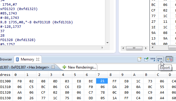

I have another question. How to read unsecured MCU (Ex. S12ZVCA) and save it to PC?
Aaron

Let's assume there is running code in the MCU.
The easiest way is to create a new bareboard project
and do not change anything but:
1) Open a debug configuration
2) Select attach
3) You can look into a memory window and press export
4) Select entire memory and the name of the file
Thats all.....
