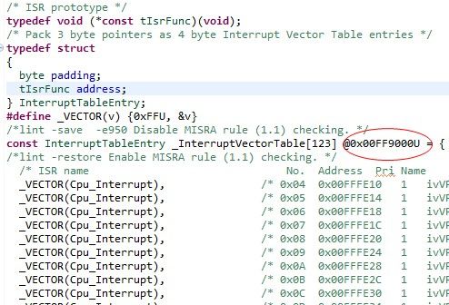

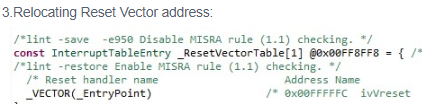

     I use S12ZVC,  I don't want bootloader and app use the same Interrupt Vector table,so i Relocating app interrupt vector table at other address:0xFF9000-0xFF92EF.
     1.I modify the PRM file,Reallocation of address:
       APP: 0xFE0000-0xFF8FFF;
       APP interrupt mapping: 0xff9000-0xff92ef;
       Boot: 0xff9400-0xffddff;
       Boot interrupt mapping :Default interrupt vector address (memory end);
     2.Relocating interrupt vector address:
     3.Relocating Reset Vector address:
     4.Set IVBR REG:0xFF90:
     5.Modify APP's RPM :
     6.Debug issue problem:
       debug by step,the program run at MainLoop() leave,can not run correctly....
  • Is there any problem with the  configuration?

I have noticed one thing, you set IVBR = 0xFF9000.
And reset vector at 0xFF8FF8.
It should be 0xFF91FC. Can you please try it?
