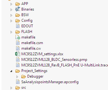

pratibhasurabhi
Contributor V
In my workspace,in the project tree ,Project setting->Linker Files is not present as below
