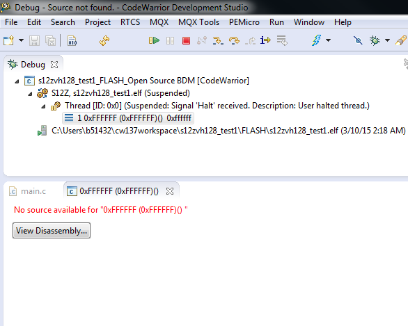

I use CW 10.6 , create PE project .
When i use "Internal clock" , it is 1MHZ, what's the biggest bus clock ?
When i select  30MHZ or 50 MHZ "Internal bus clock " , when build , there is no error ,while , when debug , it show
Could you tell me what's wrong with me .
And when i select 20 MHZ bus clock , it can work well .
Thank
1,708 Views
iggi
As mentioned initially, the 'biggest' bus clock is 50MHz. I tested this using PE tool and the bus clock works OK (there is some deviation from target freq, but it works). It looks like you are having some other problem during debug. Are you stepping through the code?
Sometimes it is better to use breakpoints, run the code and observe signals on the scope or use LED indication. For example, you can use ECLK on PP0 pin to see the bus clock. This can be enabled by clearing the NECLK bit in ECLKCTL reg.
