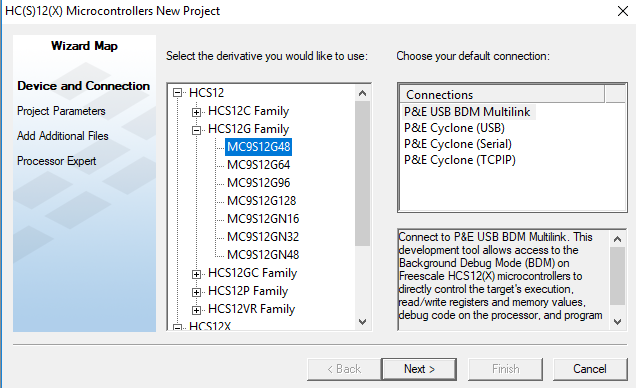

I'm having a similar issue.. My eval CodeWarrior 5.2 doesn't support the G48 (but it does G96 and G128 if I recall).
I downloaded Codewarrior V5.1 on an old XP machine as well as the G64 service pack (which should have G48) but G48 still doesn't show up on the project->Change MCU/Connection option list.. G64 does now.. but not G48.  Where can I find the config file for G48?  Thanks!
3,822 Views
RadekS

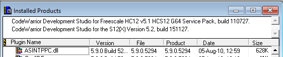

Hi Greg,
Please download G64 service pack for CW5.1 (CodeWarrior for HCS12 v5.1 G64 Service Pack.exe) and install it on your PC with Win10 and CW5.2.
During the installation, please ignore note about the necessary PE update and change the default path to CW5.2 directory.
When you will run CW5.2 again, the G48 should be available.
Tested on my side now.
I hope it helps you.
Radek
3,822 Views
greghanssen
Thanks Radek!  Interestingly I still don't see G48 in the Project->Change MCU/Connection (although G64 has been added).
It seems the processor expert now acknowledges G48 not that that's a huge deal for me, but interesting.
More importantly the HiWave debugger now sees G48 under Select Derivative (0x1c5) and so even though I compiled as a G64, I have been able to flash the G48 on my board and the clocks seem to be working as expected.  I think I'm on the right track now.. just need to get CAN working :smileyhappy: Thanks again!
