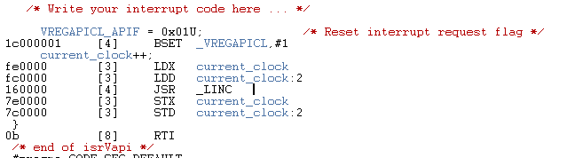

I wrote a C code to use API as my system base timer, I want to relocate the interrupt service routine into RAM segment, but when debugging, I found the “current_clock++ “(a unsigned long variable) will invoke a function "_LINC"  which is locate in the ROM.
How can i put the entire interrupt routine into RAM?

_LINC is the run-time function to perform increment of 32-bit (long) integer. Since there is no hw. instruction support for this operation this is done by a routine instead.
One solution is to copy and paste the file below into your local project:
"c:\Program Files (x86)\Freescale\CWS12v5.2\lib\hc12c\src\rtshc12.c"
Now you can adjust the function to be placed into your RAM section "RAM_CODE"
/*---------- Long INCrement ---------------------------------------------------*/
/* D:X = (D:X)+1  */
#ifdef __cplusplus
extern "C"
#endif
#pragma push
#pragma CODE_SEG RAM_CODE
#pragma NO_FRAME
#pragma NO_ENTRY
#pragma NO_EXIT
void _LINC ( void ) {
  asm {
        IBNE  D,done
        INX
  done: RTS
#pragma pop
Change the link order so the linker now prefers to uses the source file instead of the ANSI library:
Build the project and check the map file - now both isrVapi and _LINC are located in RAM_CODE section.

The drawback of this approach is that if you perform long increment in any other place of your code it always calls the RAM instance of _LINC.
If you want to have two separate instances for RAM and FLASH you should probably replace the  C increment statement in your interrupt handler:
   current_clock++;
with a custom function call e.g.:
   current_clock=_LINC_RAM(current_clock);
And create your custom version of long increment function in RAM.
Hope it helps.

Hi,  Stanislav Sliva,
      Thank you for your help!  On your suggestion, I modified my code to the following
#define lONG_INC(var)     ((uint16_t *)&var)[1]++;\
                          if(((uint16_t *)&var)[1] == 0){\
                              ((uint16_t *)&var)[0]++;\
**     Interrupt handler : isrVapi
**     Description :
**         User interrupt service routine.
**     Parameters  : None
**     Returns     : Nothing
__interrupt void isrVapi(void)
  /* Write your interrupt code here ... */
  VREGAPICL_APIF = 0x01U;              /* Reset interrupt request flag */
  lONG_INC(current_clock);
/* end of isrVapi */
#pragma CODE_SEG DEFAULT‍‍‍‍‍‍‍‍‍‍‍‍‍‍‍‍‍‍‍‍‍‍‍‍‍‍‍‍‍‍‍‍‍‍‍‍‍‍‍‍‍‍‍‍‍‍‍‍‍‍‍‍‍‍‍‍‍‍‍‍‍‍‍‍‍‍‍‍‍‍‍‍‍‍‍‍‍‍‍‍
