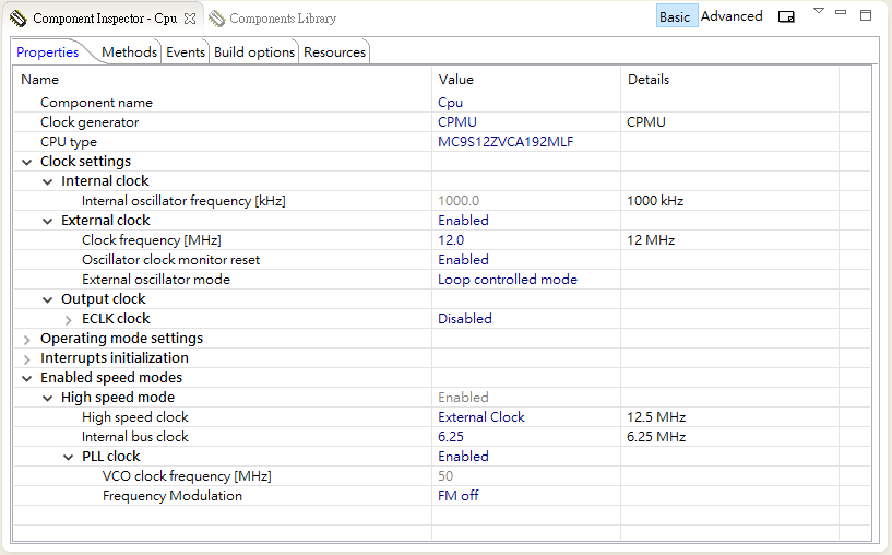

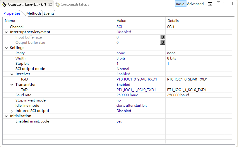

We are using a S12ZVCA with the 12MHz external crystal. I need to have a 250 kbps baud rate on SCI.
I have try to receive 4 bytes, but only receive the 1st bytes.
Processor Expert setting as follow:

Hi Aaron,
If the value of the SCI1SR1 register is 232 it means the overrun occurred.
When Rx buffer is not empty (not read) and further data are received the overrun flag is set. That’s why the data are lost.
See chapter "14.3.2.7 SCI Status Register 1 (SCISR1)":
Overrun Flag — OR is set when software fails to read the SCI data register before the receive shift register receives the
next frame. The OR bit is set immediately after the stop bit has been completely received for the second frame. The data in the shift register is lost, but the data already in the SCI data registers are not affected. Clear OR by reading SCI status register 1 (SCISR1) with OR set and then reading SCI data register low (SCIDRL).
Your bus clock frequency is 6.25 MHz. So, increase the bus clock frequency to maximum - 32MHz can help.
Let me know if it helped you.
Diana

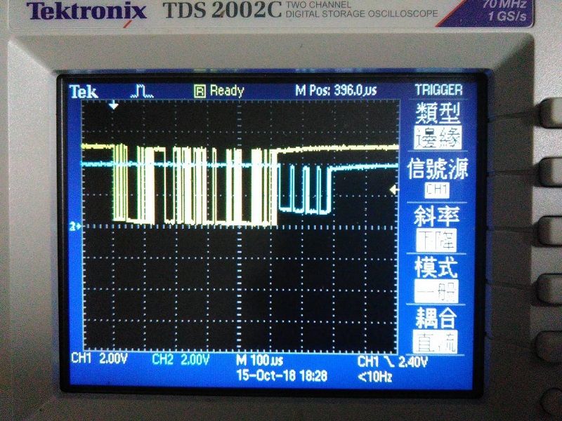

Hi Diana,
My project as attachment.
SCI baud rate is 250,000bps
The error as following:
if (StatReg & (SCI1SR1_OR_MASK|SCI1SR1_NF_MASK|SCI1SR1_FE_MASK|SCI1SR1_PF_MASK)) { /* Is any error flag set? */
Result = ERR_COMMON; /* If yes then set common error value */
StatReg = 232 when receive the CH2(blue). Sometime read 2 bytes
Yellow: Send command from S12ZVCA_SCI_TX to bq76PL455A_RX (Data: 0x.......81 00 51 00 15 AC)
Blue: Feedback from bq76PL455A to S12ZVCA (Data: 0x00 80 01 A0)
I have been try using PC to instead of bq76PL455A. The S12ZVCA can transmit command to PC and receive PC feedback. The different is PC take a longer time (>1s)
from S12ZVCA transmitted command(Yellow) to starting receive feedback(Blue).
Do you have any recommend?
Aaron

4,696 Views

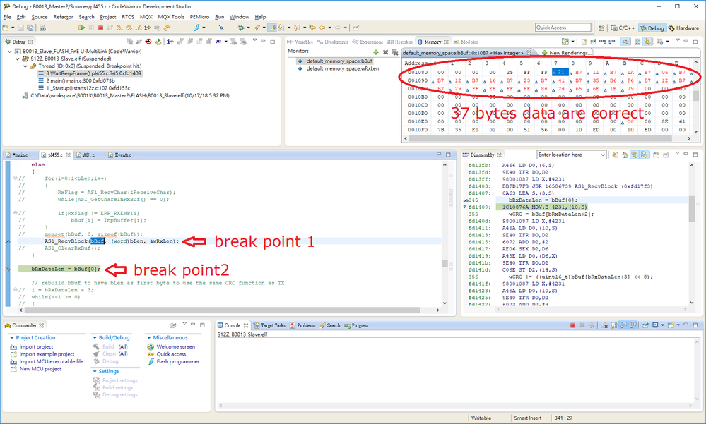

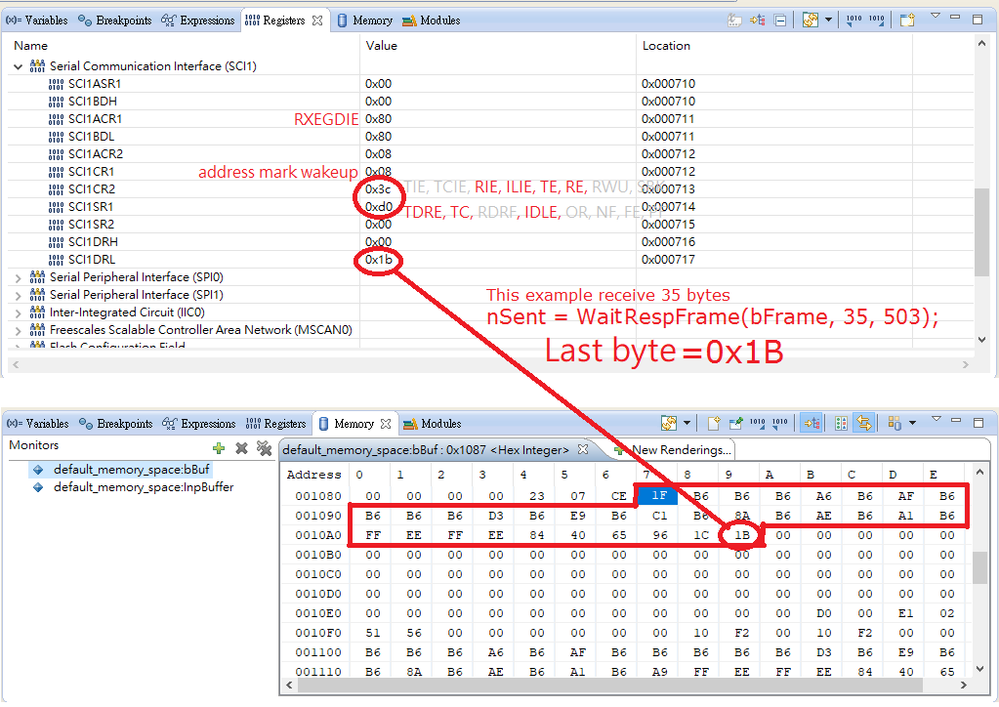

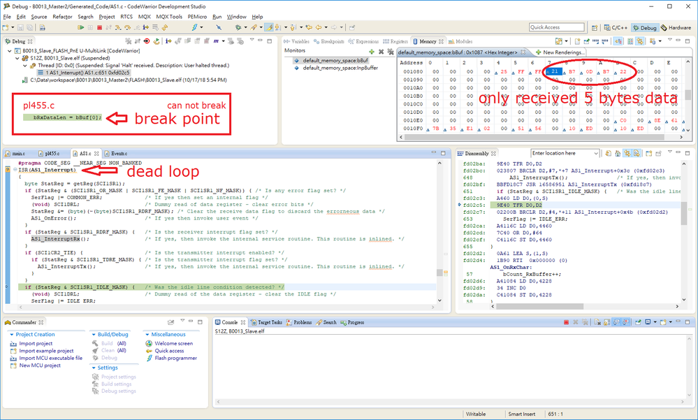

aaronlee
Contributor V
Hi Diana,
The overrun issue is resolved by 32MHz bus clock. Thank you.
But the next issue is program dead-loop in ISR(AS1_Interrupt).
We use DEBUG step by step. And we can see dead-loop at "main.c line 300"
main.c
line 300: nSent = WaitRespFrame(bFrame, 37, 503);      // Call pl455.c
Press suspend for check the SCI1 registers
We setting BREAKPOINT to "pl455.c line 341 & 345". Then run it. bBuf can received 37 bytes data.
pl455.c
line 341: AS1_RecvBlock(bBuf, (word)bLen. &wRxLen);      //  Break Point
line 345: bRxDataLen = bBuf[0];   //  Break Point
We setting BREAKPOINT to "pl455.c line 345". Then run it. Program can not stop at BREAKPOINT.
pl455.c
line 345: bRxDataLen = bBuf[0];   //  Break Point (Can not stop)
How to stop ISR(AS1_Interrupt) and return back?
Please see attachment.
Aaron

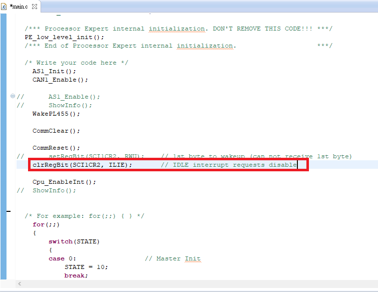

aaronlee
Contributor V
Hi Diana,
We are adding the mark of code. It can resolve my issue.
Why the idle interrupt request(SCI) trigger frequently?
What situation were trigger this ilde IRQ ?
Aaron
