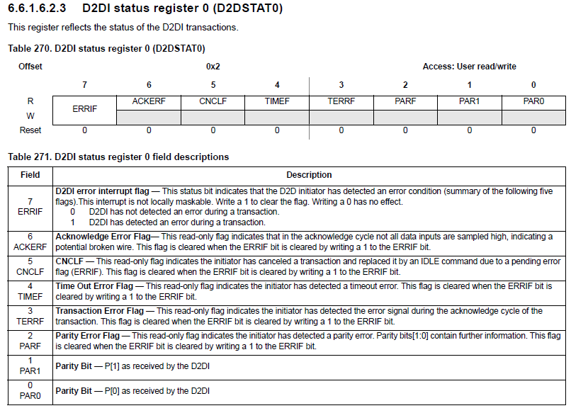

		if(D2DSTAT0_ERRIF)  {
			D2DSTAT0_ERRIF = 1;											// clear flag

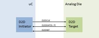

1. The D2DErr Interrupt is caused by errors detected by the D2D Initiator, which is the D2D module on the uC side. The detected errors are signaled in the D2DSTAT0 register.
This error could e.g. be caused if the analog die is in STOP mode and the uC tries to access the analog die. As the analog die does not correctly react to the D2D Initiator request, this will generate the D2DErr Interrupt.
2. The PCRReset() is trying to perform a write to a register on the analog die, which is using the D2D interface, as this interface seems to have an issue the write fails here.
