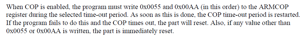

Hello Marco,
Yes, if you have not write 0X0055 and 0X00AA tothe ARMCOP register during the selected time-out period , it will reset.
We can see this in the   MC9S12E256 Data Sheet -> 4.4.5 Computer Operating Properly Watchdog (COP)
When time out ,a  reset will occur very quickly and you may not be able to see the ISR entered before the reset occurs.
So you have not see it call the interrupt.
Hope it helps

Molibdeno
Hello Alice,
I already ARMCOP use in my program, but if the program crashes should call ISR
How do I disable the CPU reset?
How do I call first ISR?
Thanks for the help
