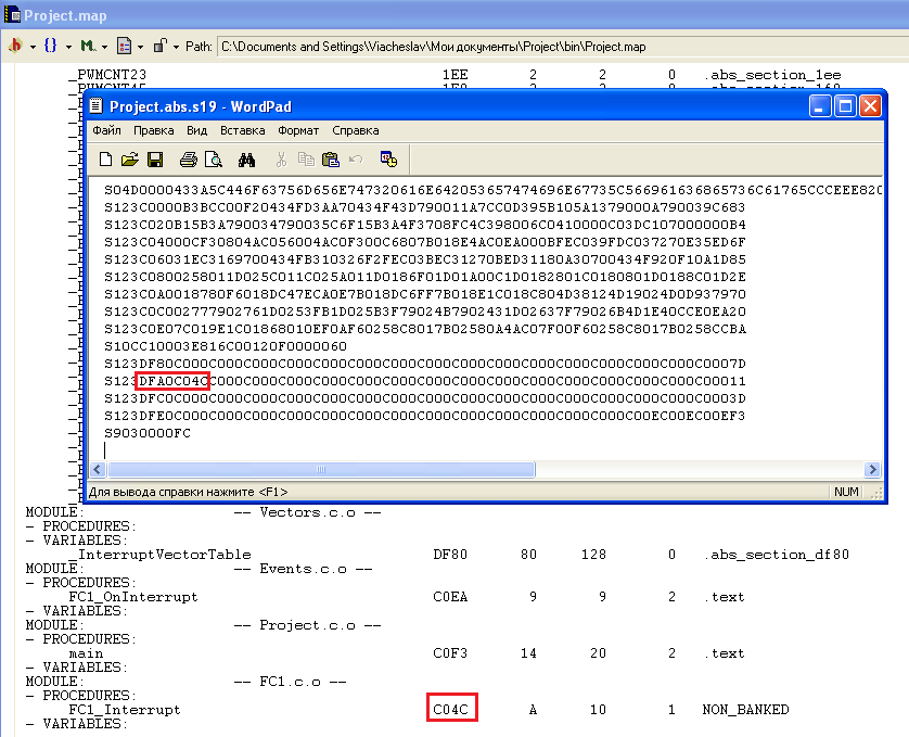

I'm using 9s12e64 MCU and trying to write my own bootloader (it does not use interrupts) IDE CW5.1 + processor expert
Bootoader placed at address 0xe000-0xffff. Secondary interrupt table placed at 0xdf80-0xdfff Bootloader works fine, gets firmware, jumps to main application. Main app works. But there is on issue: I can't use interrupts in my main application. when interrupt occurs, MCU "hangs" (LED stops blinking) I've read AN2153, looked through AN2153SW and CW & HC12D60A VECTOR RELOCATION
Can anyone help me?
Here is some pieces of my code, where can be mistake:

Hi, Everyone. I think, my problem has been found.
When interrupt occurs, MCU serves interrupt in main firmware and hangs somewhere after RTI instruction.
So, some instruction corrupts stack. Here is disassembled code of interrupt in bootloader:
LDAA 0x30
PSHA
JMP [0xFF04, PC]
PULA
STAA 0x30
RTI
additional operations with stack - because of my compiler settings =)
Thank you all for the conversation.

viacheslavbala1
Thank everyone for replies.
vector table placed in .s19 file at necessary address (starts at 0xdf80, ends at 0xdfff). It is also present in *.map file.
main app works fine without bootloader (if I placed interrupts to 0xff80). In this case *.s19 file is not changed (only vector table address). So my mistake probably somewhere in bootloader. The worst thing: assembler language is some kind of magic for me :smileyhappy:
may be I have to attach my bootloader project?

RadekS
Hi Viacheslav,
The old S12 devices, unfortunately, do not contains IVBR register for shifting vector base address.
I suppose that I understood to your construction, but I am not exactly sure why it do not work.
The main problem is that application interrupt vector table belongs to flash occupied by the bootloader.
Your implementation contains ISRs in bootloader code with simple jumps per application vector table.
I am not sure with your jump command like asm JMP [0xDF88,pcr];
This command use indexed addressing.
I suppose, that when address 0xDF88 contains directly vector to application ISR, you should use extended addressing like asm JMP #DF88;.
The JMP opcode for extended addressing is 0x06 and 0x05 for indexed addressing. Please check generated extVpwmesdn() code.
Edward,
The PE defines ISR() as #define ISR(x) __interrupt void x(void)
So, #pragma TRAP_PROC should not be necessary. The interrupt keyword is used instead of it.
I hope it helps you.
Radek

RadekS
Hi Edward,
You are right with JMP address. My fault.
About optimization)
good point. It might be next potential root cause.
Viacheslav,
Linker optimize out nonreferenced constants as unused. Please check generated map file in bootloader and application projects.
You may place constant name into ENTRIES section in prm linker file for avoiding that optimization.
Radek
