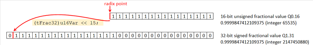

eqation(1) :: f32ErrorVar = (tFrac32)40000 - fsu16Var
fsu16Var -> (variable consist frac16 but only contains positive value and sometime its value can go more then 32767 but less then 65535 so variable datatype definition is used as unsigned16)

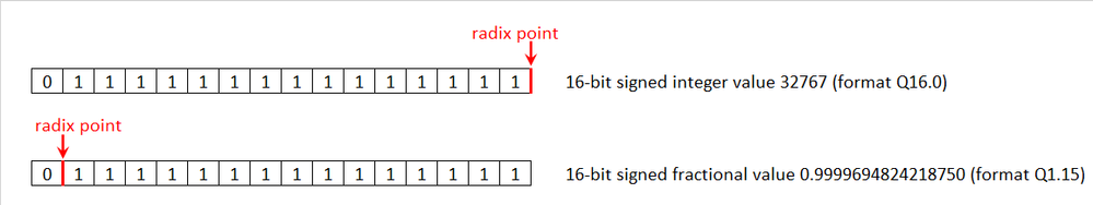

It is important to understand that fixed-point fractional arithmetic works with fixed range and variable resolution. What that means is that regardless of whether your integer representation goes up to 32767 or 65535 or even 2147483647, it will always correspond to the same fractional range [0.0; 1.0) in case of unsigned arithmetic and [-1.0; 1.0) in case of signed arithmetic.
We write integer constants in the code only because the C language does not allow us to write fractional values directly (i.e. we write 32767 instead of 0.9999694824218750). Both 32767 (as 16-bit signed integer) and 0.9999694824218750 (as 16-bit signed fractional) correspond to the same bit pattern in the CPU register:
AMMCLib functions work with signed fractional values which are in the fixed range [-1.0; 1.0) and the resolution is 0.00003052 for the tFrac16 type and 0.0000000004657 for the tFrac32 type.
You will need to decide what should be the fractional format representation of your variable fsu16Var. If you want to represent it as Q0.16 unsigned fractional value in the range [0.0; 1.0), then you will need to cast it to tFrac32 and shift left by 15:

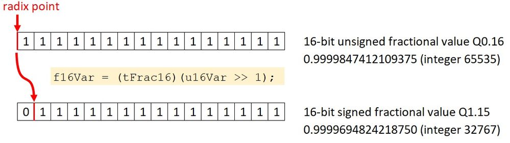

Is there any library that supports conversion of unsigned 16 variable to signed 16 value or any approach that can be followed to achieve this type of conversion.

We don't have a dedicated library function for this conversion, but it can be achieved with one line of code. Assuming that you have a 16-bit unsigned fractional value in the Q0.16 format, you can convert it to 16-bit signed fractional value in the Q1.15 format by shifting it right and then casting the result to the tFrac16 type. This will map the input values from the original range [0.0; 1.0) to the new range [-1.0; 1.0) and reduce the resolution by 1 bit (you lose the least significant bit in the shift right operation).
