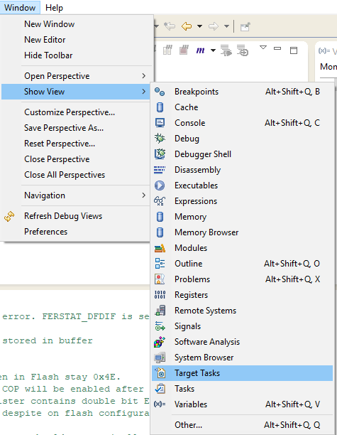

you may use the Flash Programmer task for that.
1. go to menu->Window->Show View->Target Tasks
if this option isn't visible in the list, select Other... and search it in Debug folder.

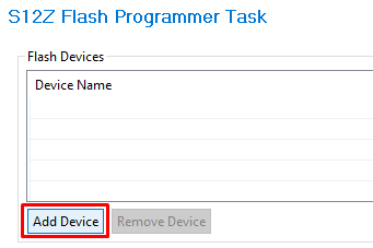

3. add your MCU as a device

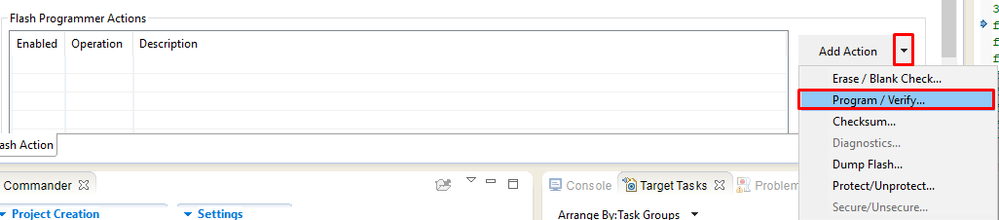

4. Add program/verify action

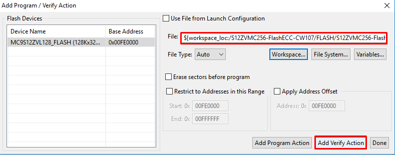

select path to the elf file and click on add verify action

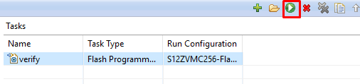

5. Select created target task and run it

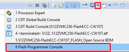

6. display Flash Programmer Console for more details
