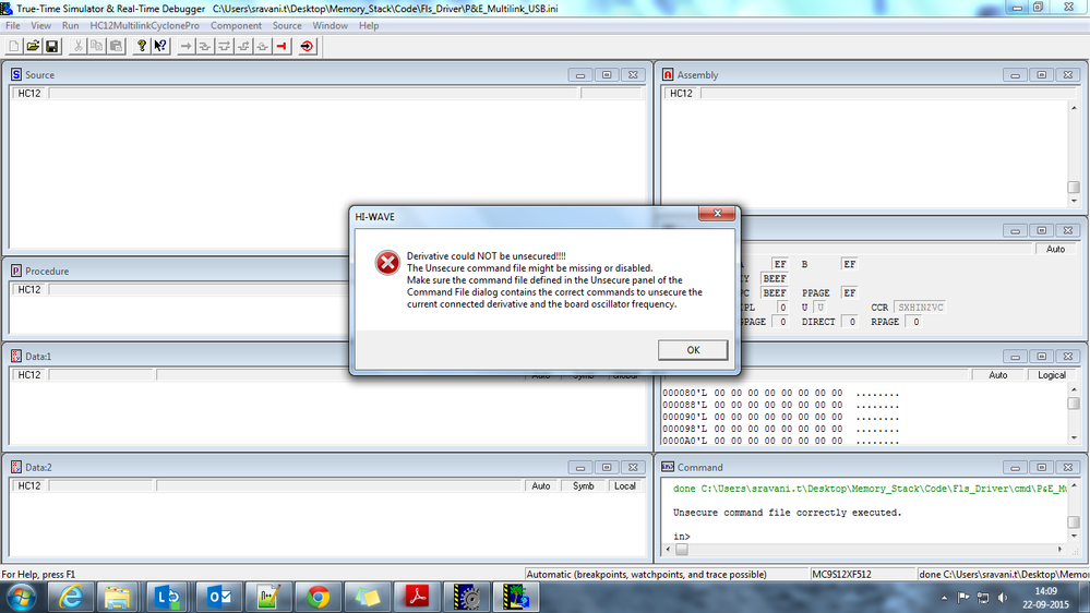

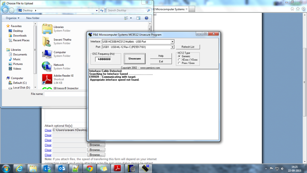

sravanithatha
Hello Radek,
I have checked the power supply, its fine. Jumper J27 is removed already.
The same code when i am trying to flash in some other working board its getting flashed.
but in the problem board that BDM error I got when i tried to connect. and when tried the unsecure option in P&E debugger, I got below error.
Even I tried the tool: unsecure_12_install from the link:
http://www.pemicro.com/downloads/download_file.cfm?download_id=16
when i tried to unsecure with this i got below error:
please help me to recover the board.

RadekS
Hi sravani,
CW told you that debugger cannot found command file for unsecure.
Please check whether your project contains file P&E_Multilink_USB_Erase_unsecure_hcs12.cmd in this path:
"..\<YOUR_PROJECT>\cmd\P&E_Multilink_USB_Erase_unsecure_hcs12.cmd"
For Unsecure12, please select XExxx/XSxxx in HC12 Type option.
Please double check your clock settings on board and enter into CW/Unsecure12 real oscillator clock frequency.
I hope it helps you.
RadekS

sravanithatha
Hello Radek,
CW debugger has the correct path from the project, but still it shows the same error when i do unsecure command.
However with the unsecure tool which i installed in that i have selected the option of XExxx/XSxxx, It worked MCU is unsecured and could flash new s/w successfully.
Thank you so much for the quick replies which helped me alot.
