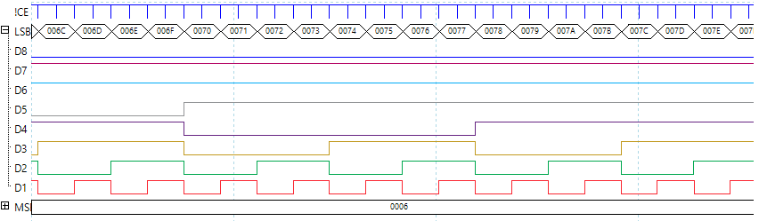

The image below show a log of access to some addresses in the external memory.
Access to External RAMAccess to External RAM
However, I can't execute code which I stored in the external memory.
