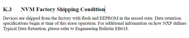

Hi I am working on MC9S12ZVC micro, in Reference manual NVM Factory Shipping Condition mentioned as below
My question is after erasing the EEPROM what is the default value of EEPROM without program the EEPROM?

It is the same for both Flash and EEPROM, an erased bit reads 1.
